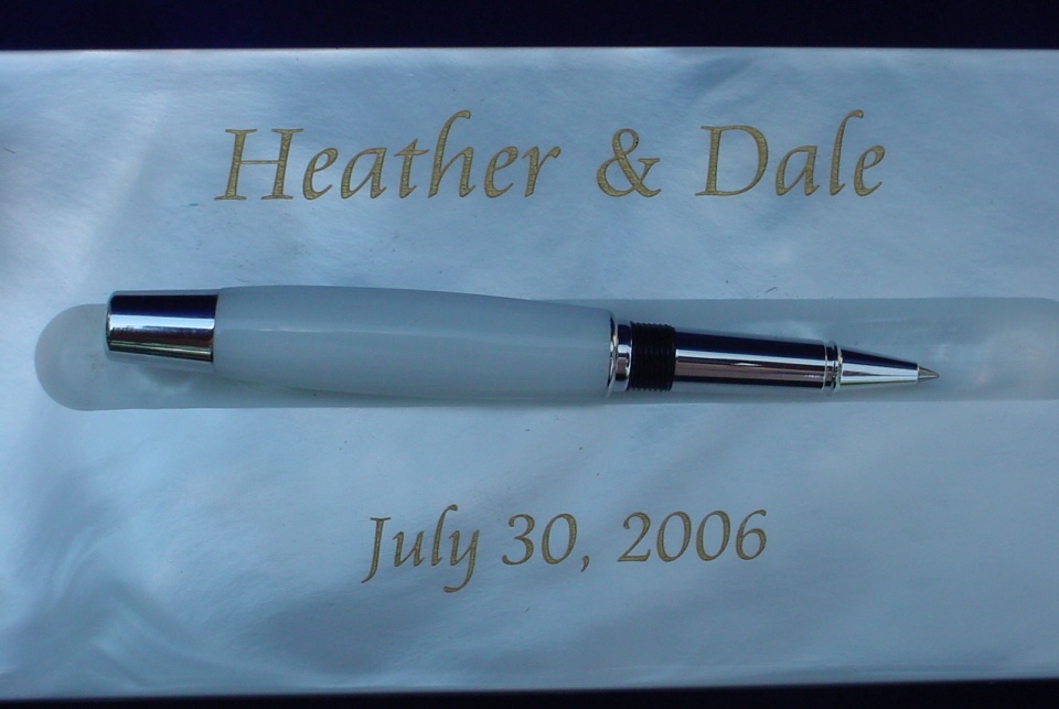

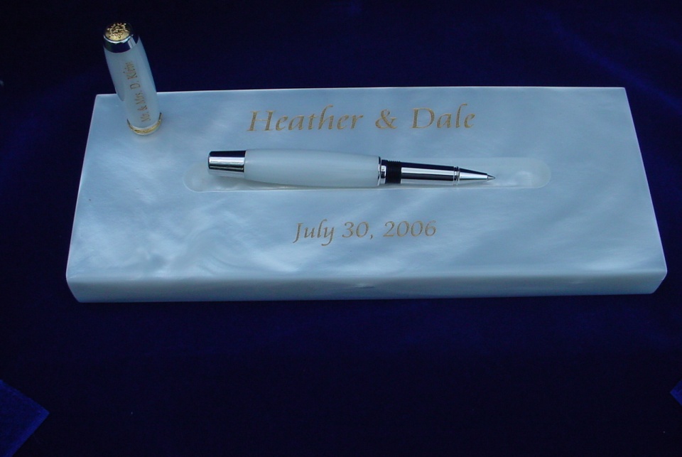

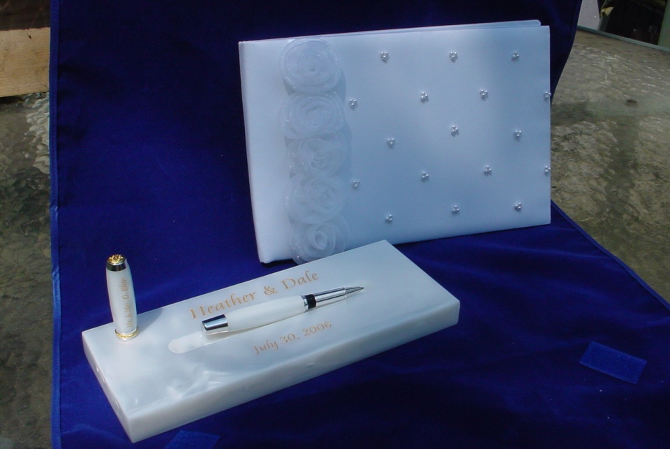

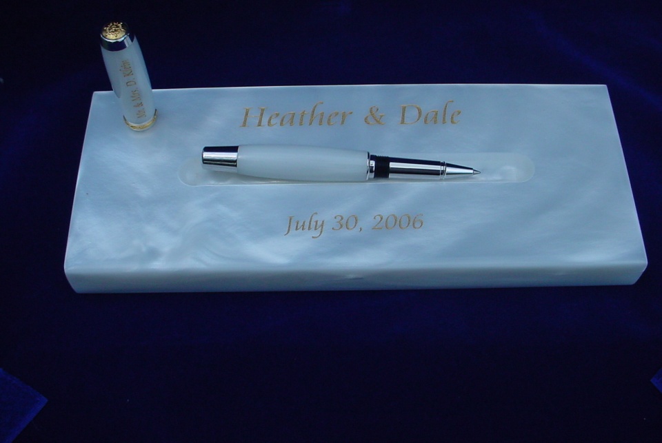

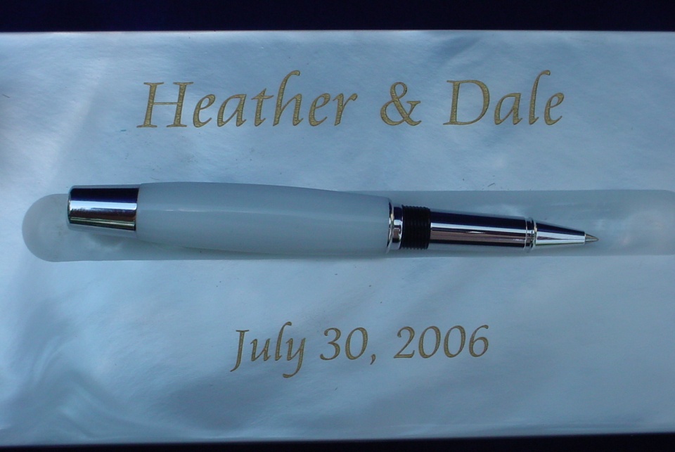

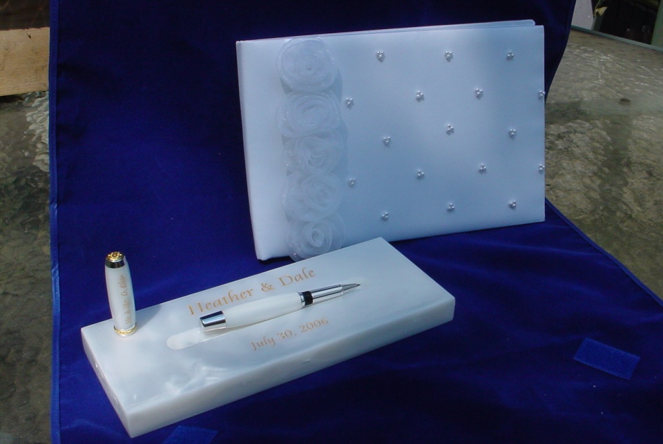

Thanks, I forgot about the picture request. I made this for a friend's wedding.
