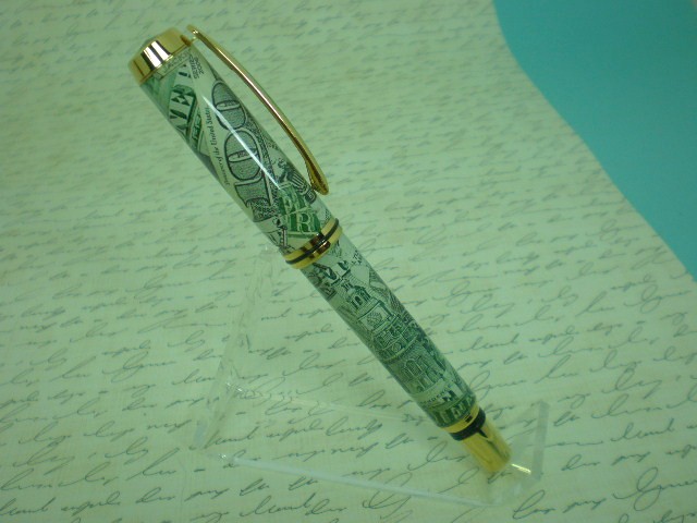

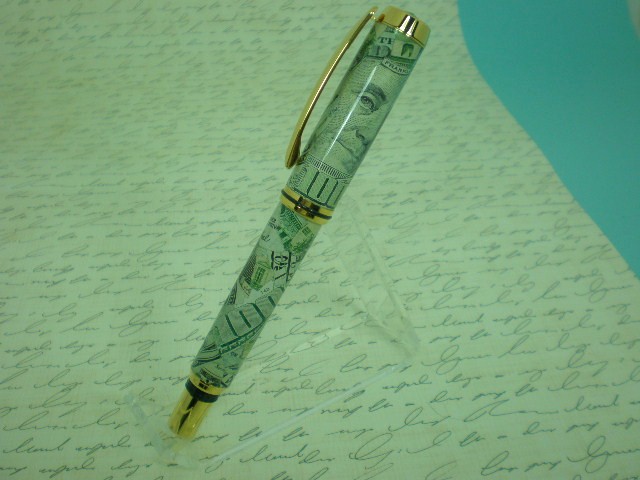

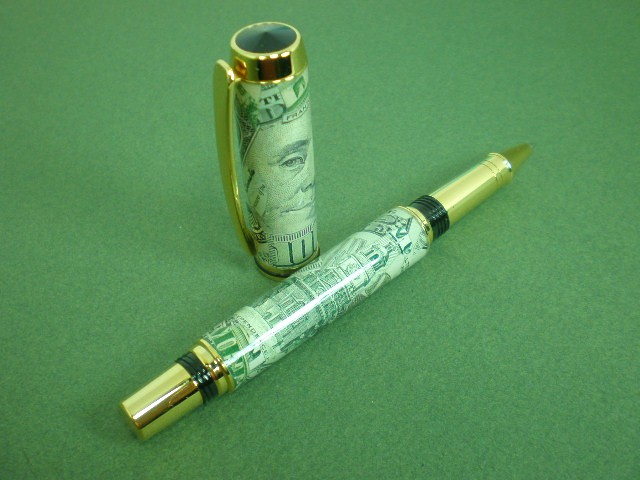

Thanks, guys. Closed it is. Attached a couple of photos to show how it turned out.
