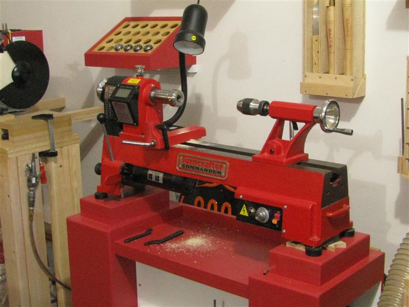

RetiredJake
Jan 11, 2012
225
Tucson, AZ
for me though, i think it's because i have a standard lathe, and i'm a tall guy, so i spend most of the time hunched over....
i think i need to make risers or something for it.
I had the same problem. I made my lathe stand from a set of plans in ShopNotes magazine. Turned out to be too short. I laminated some MDF blocks, painted to match and lifted the lathe another 2 1/4". Just right now.
