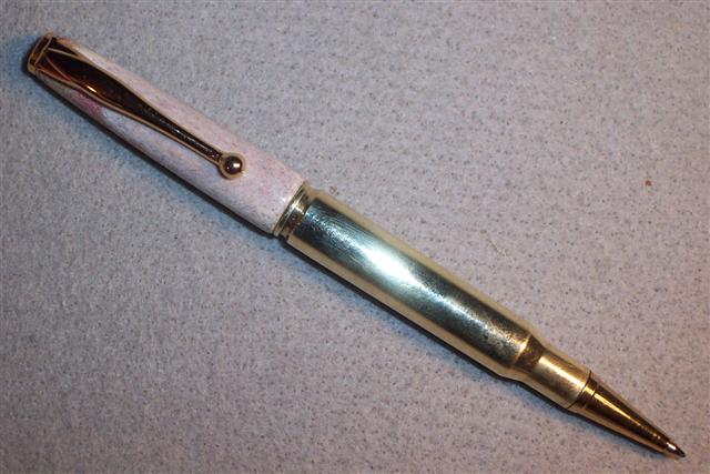

I have already done it.
The 7 mm nib gets "reamed" out to accept the PArker refill.
It is touch and go.There are issues with the "shoulder" inside the 7mm nib the spring needs to rest on.
If not done exactly right the refill will protrude too far.
I make these for my own use and don't sell them but it can be daone.
I made a couple of 30-06's antler casing pens this was.
Without "resizing" the neck a 30-06 won't take a Parker size nibe with the fit being compromized.

Note to Eagle-This is not meant as a challenge, you have enough to do, don't start modifying 7mm tubes to prove me wrong here!!!!
Sorry ED
I missed your reply.
There is a little decption involved.
I use 2 tubes for the bottom part of the casing pen.
A short 7mm tube gets "glued" into an 8 mm tube for a parker refill.
This gets glued into a wooden blank that fits into a 30-06 shell casing.
The 8mm tube is a good fit in the 30-06.
The transmisson holder gets ground down to fit into the upper section of the casing.
I no longer have this pen, gave it away but this is one I made into a PArker refill casing with a 30-06.
