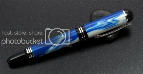

Churchills are my favourite and Ernie at Beartooth Woods is my go-to-guy.
Nicely balanced and the perfect size for me. Here's my latest as a gift for someone in his soccer team's colours.
