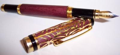

CL (Chris),
Where did you get the kit to make this pen?
Image Insert:
11.45KB
I showed it to everyone in my office and they all love it. I am therefore compelled to make one. Thanks in advance. Very nice pen!

As Doghouse said Woodcraft carries it. The woodcraft part number is 129961. Uses the Fountain/Roller Ball bushing set 06S89 if you don't have a comparable bushing set. One other note. There are no replacement tubes for the pen cap. Found that out the hard way. Had to find a longer tube of the correct diameter and cut it to length. Well ok close to length since i had didn't know the exact length of the original :p

CL I had the same problem except for me it was too late.
When you turn it
1 make sure of the lengths when picking top and bottom.
2 before you cut the tenon, test fit the spiderweb and mark the blank for proper tenon location.
Also Berea sells other filigree pens with different cutouts. They have them in both silver and gold.
