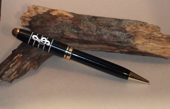

Another technique I have used to get very crisp lines is to cast a blank or even a flat thin layer with the inlay materal, drill a hole for the appropiate tube size, slice/saw/sand off a layer however thick you want the line, then glue it up with balance of the blank material and turn from there. This works with wood or PR resin casts. I used this technique to get the staff line on my music pen. Takes some time, but you can get very crisp lines of any thickness with virtually any inlay material.

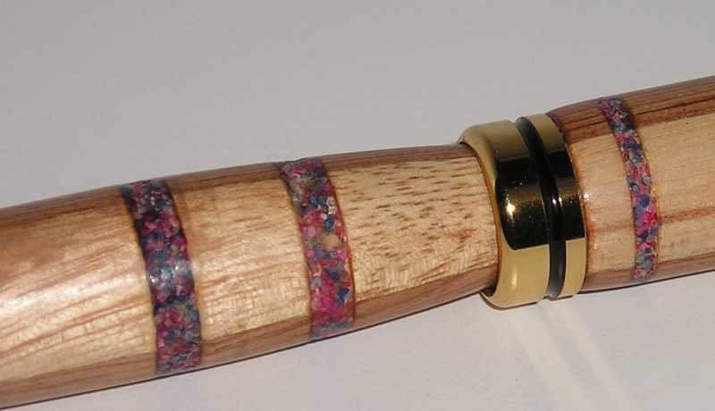

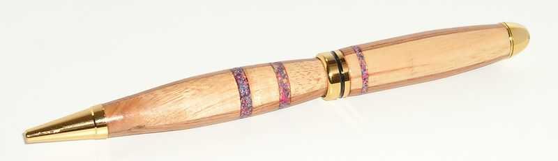

More than one way to skin a cat. My skinning method is to turn just a tad over finished diameter. Put the inlay powder in and CA with thin. Then finish turning to finished diameter. I have been using embossing powder...used by scrapbookers... It comes in lots of colors and is much cheaper than powdered stone. Be careful powdering abalone shells. I understand the dust is very harmful. Those who do it commercially grind the shell under a water bath of some kind to keep the dust out of the air. I was told this....Only trust the advice is true. I've attached a picture of two inlay rings using embossing powder. The powder can also be mixed with two part epoxy or colored two part epoxy can be used. Good luck.
