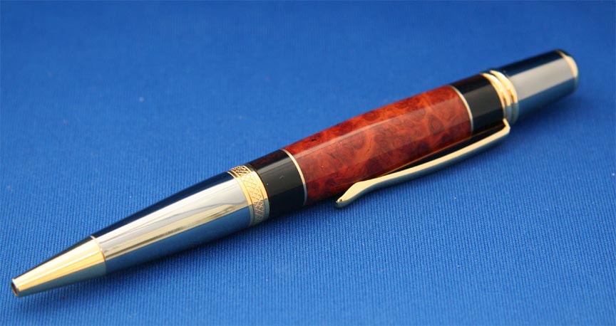

I just accept that I can't do that and cut the size and shape that I want. THEN, I place the cutouts between sheets of thick plywood or usually flat 1/2" thick steel and hit it with a hammer to flatten it. I have been doing that for 3 to 4 years.
AS a help in cutting "rings" or "washers", I place a sheet of 4 x 12 inch brass between 1/2" sheets of plywood that is oversize by 1 in on each side. Then I screw the two sheets of plywood together about every two inches. Next, I mark a grid and drill holes the size that I want. Take the screws out and use sheers to cut my washers around the holes.
Pound them flat as mentioned in the first paragraph.
That is the way I made the rings for this pen and others:
http://www.penturners.org/photos/images/940/1_Best_pen.jpg
