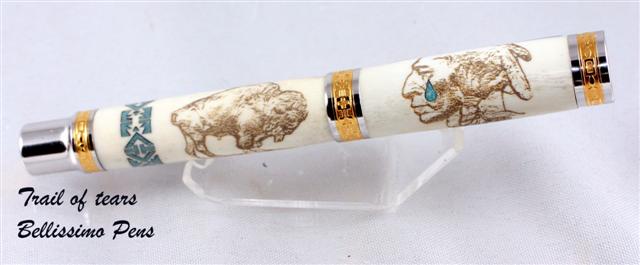

I was wondering what kind of finish should be used on a $1000-$2000 pen with a material that is similar to wood. Is there a finish that should be used other than CA for a pen in this price range? Is polyurethane better? I have read the IAP article using the dipping method though I have not tried it and don't know if that is something to consider. I'm willing to put as much work as is necessary to get the best finish possible for this type of pen.
Any advice from the "experts" is greatly appreciated!
