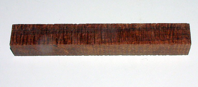

With some of the worlds hardest and unusual timbers I prefer and use drill point drills made in the USA still cheap as and the very best. When i spent a long time building with 6 inch 3/8 walled steel posts they enabled me to drill more safely and easily off a ladder at height in fact for all seasons in all places the DeWalt Extreme 2 drill Point drills have a small drill point lead then shallow lands developed so long ago for difficult metals.
I buy them here easily their range is extensive getting hundreds of drillings with them amortised over all my preference. Its all well and good sharpening repeatedly other drills but by then the other important parts of drills needed for clean cutting are stuffed all you acheive is the point and lands.
Like the ancient man at the seaside when he held the guy underwater and pronounced when you want to breathe as much as you did just now you will put the effort in yourself.
A very low number of commercial drills are really accurate in their true size when I have the need I buy top stuff at least one under and one over my calipered choice.
I always mike my brass blanks or use a go no go guage with them before I rough them or choose them.
OK so much for the basic necessities I drill on the drill press have never changed drilling speed from fairly high often drilling continuousl hunderd or two blanks at a time. All electric motors are rated for cycles ie so many switching operations on and off over a stated time.
My drill press is unimpressive but the first things I did was chuck the rubbish bearings, the horrible underpowered motor for a one HP 240 single phase motor and I switch the drill on once in a session this needs care and easy fastening XY vice with horizontal vees through and vertical allowing easy as centering blanks cut to get the best grain.As a sparky for 60 yrs I tested my motors for the start current 40 brief amps is not uncommon at start even the drill start instantaneous though it is often the mains power here is up to 250 volts single phase. Progress has come to drills with variable speed and soft start another wonderful choice.
Rarely have a break at exit in a blank never put a waste wood under.
OK you may say tutt tutt or whatever it suits repitition blank making from real timbers and so called plastics. The drill press etc are dedicated but has served me so well for 25 yrs now another very safe thing this time is to use the threaded rod to lock the drill chuck in the column morse tapers are great but get a sideways thump and all hell can break loose.
Thankfully I only break out rarely with my preferences suggest you make your way looking at the needs, possibilities. Tools over your way are dead cheap IMHO look at Australias purchasing power total country population less than one big city over your way, mail order a way of life.
Have a beaut new year its full of promise and in my eighty years I will try to do the same. Recent purchase of Ringed Gidgee the third hardest timber in the world typical of day to day blanks that need holes in them.
Kind regards Peter.
