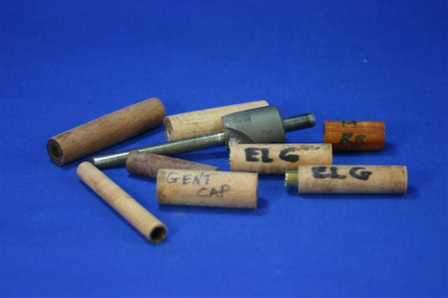

Instead of buying all of the different size shafts, glue a 7mm tube in some scrap wood and turn a shim the size you need. I have shims for all of the different size tubes and only one pen mill with the 7m shaft...much easier and cheaper. I use a sharpie and mark on the shim which kit tube it fits.
Do a good turn daily!
Don

Don's suggestion works great. As you expand your line of pen kits, it will get expensive if you buy a shaft or shafts for each kit. If you don't want to use a spare tube, drill a 1/4" hole in corian and make the smaller shims of corian.
