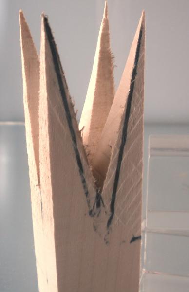

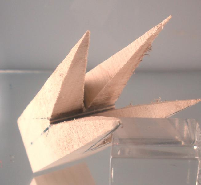

I have no clue about woodworking or machine shopping but would like to be able to make one of these very accurately and repeatable. I just rough cut this one on my bandsaw. I couldn't make the piece that would fit into it for an exact fit but I would like to be able make one of those as well. Any ideas on what tool i would use to make it, or is it just beyond a home shop to do?

I'd use a router with a perfect point 30 deg bit. But it depends on what you want from the final result.
If you matched the piece you have done already with another piece that fitted inside, do you realise that the existing long spikes will reduce in length drastically as you turn it round, but the matched piece won't.
Are you trying to get 'pool cue' type joints?

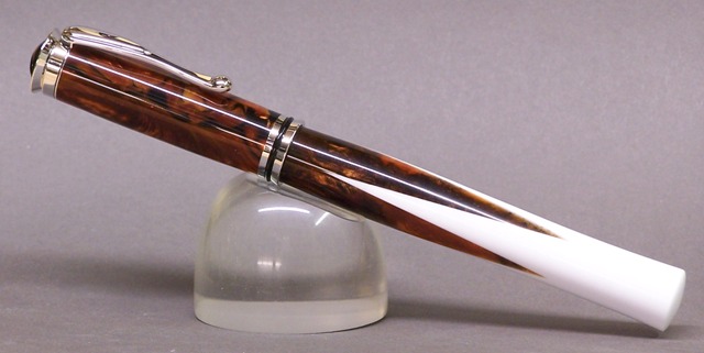

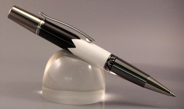

Both of these pens where done with my 30 deg router bit. The black / white one was done by the router cutting perpendicular to the end of the blanks and the other was done at with the router moving at a sharp angle to the blank.

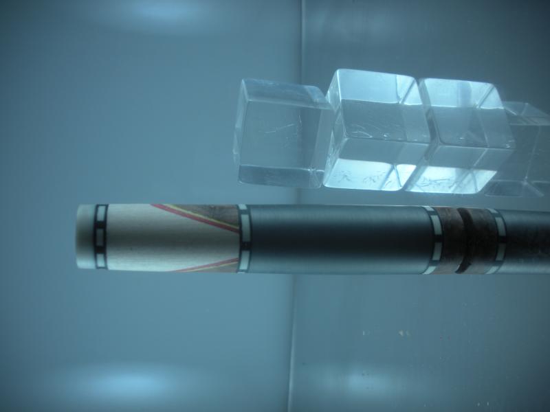

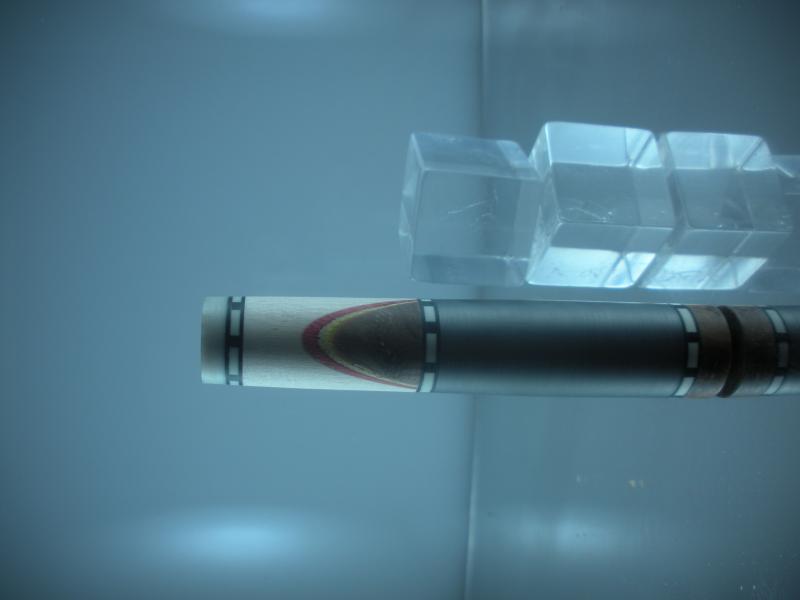

Here are some pics of a pool cue pen I am making now. The best I could do for points was two butterfly points (rounded points) I'm using a grey acrylic to simulate the wrap. I ground down a parting tool very thin and experiemented with it. I can cut very small light grooves in it and it looks like a linen wrap. I used a blank from El Mostro cut very thin and sandwiched between black veneers as the decorative rings.
As you can see the scale is somewhat wrong, but I'm still playing around with it.
I didn't edit the pics just wanted to get them posted. You are one of my hero pen makers. Any advice you can give would be greatly appreciated. I really want to make some pool cue pens.

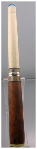

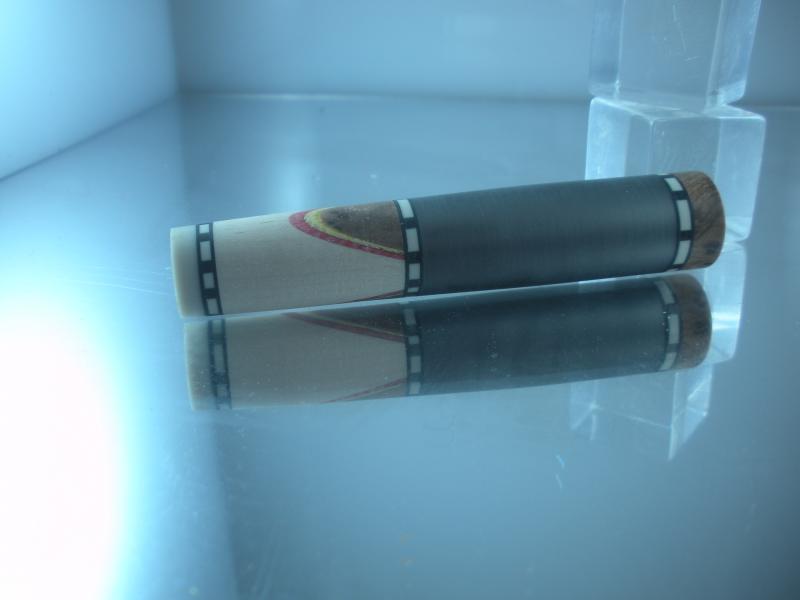

One of my first
This is the second or third pool cue pen I made. I did it about 1 year ago I think. It was before I learned to remove centerbands. The ferrule and tip are faux ivory and some blue resin from Dawn. I dont remember what it's called but it looks so much like a cue tip you think you will get blue chalk on you when you touch it.
