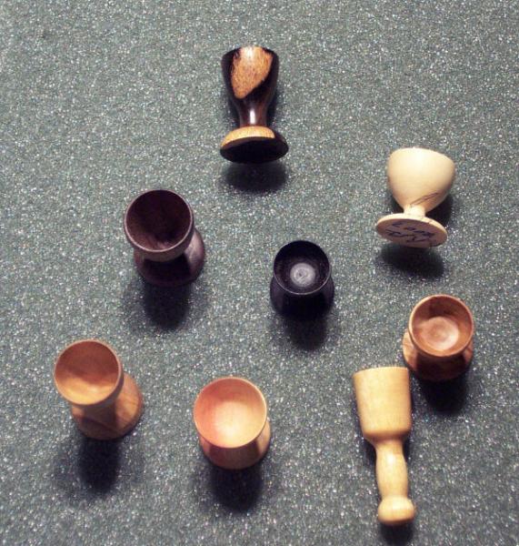

I save them and then make things like this with them. Kids like them for their board games.

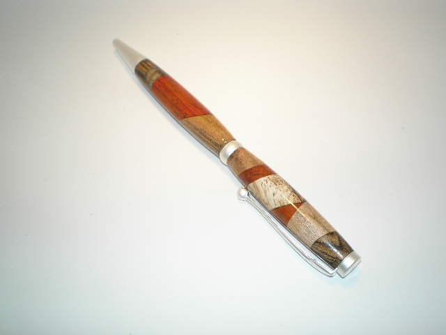

Hi Ryan, cut them at different angles, glue them togather (they will be crooked and rough looking) and make "scrap" pens.
