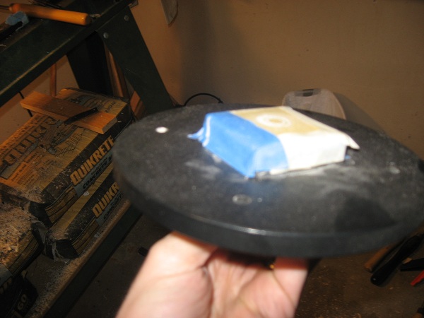

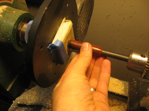

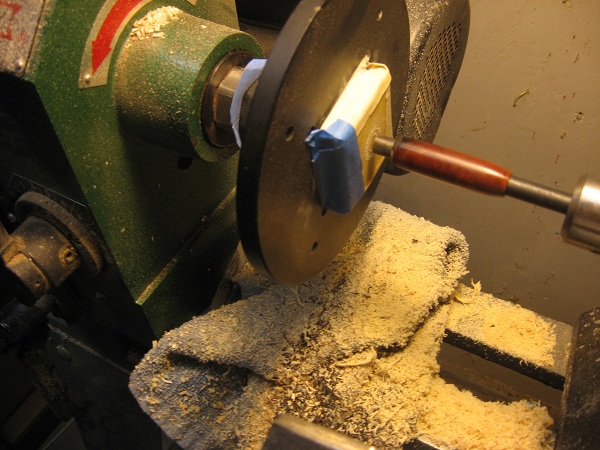

Here is a picture of the method that I use. I know that I'm not the first to do this, but it works awesome. I took the faceplate that came with my lathe and stuck a 2x2 sample of corian (free at Home Depot) to it with double stick carpet tape. Then I tape 220 grit sandpaper to the corian. I mount the appropriate size transfer punch in my drill chuck (both from HF). With the lathe on its lowest setting, I lightly touch the end to the sand paper and rotate the blank by hand to make sure that it is even all the way around. It takes just a couple of touches to do each side and it works great.
