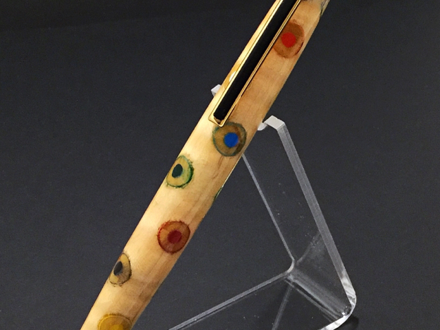

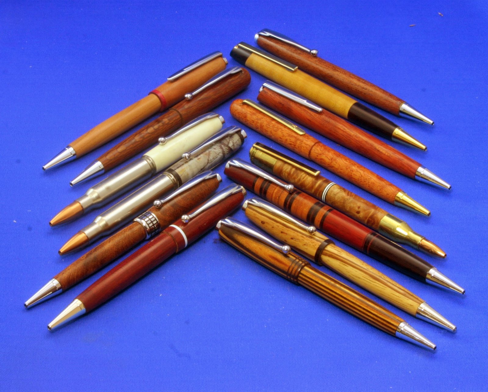

I have been accepted into a Juried art fair where all art must be priced under $50.00. For me that means Slimlines and Pentel pencils
. Here are some of my entries.

I've been thinking about your pens all day and was trying to give you my honest opinion of what I saw here. So here goes and please, please, please, take this as constructive criticism only. I'm in no way slamming your ability to turn pens, these are just my observations and I could be way off.
First off, a Slim Line should fit the title. In my honest opinion you have the option to expand the tube diameter a bit but not to what I see here. Some are way too round. Again, could be my eyes or my computer screen. I see a Slim Line as fitting into a small hand, these pictures don't show that.
#2. Many of your transitions from the blank to the center band are not true. By that I mean the tube material is not contoured or tapered down to the center band. I'm think someone putting these pens in their pockets will have trouble with snags at the center band. Leaving a square end distracts from the beauty of the pen and blank material. I also noticed that on several of the transition between the lower blank and tip.
#3. 4th picture shows three pens with deep cuts in the transition between the lower blank and tip. Again, in my mind these should be tapered down to the tip to make a nice smooth transition for the user. I also noticed what appears to be squeeze out from either your glue or wax. I'm not sure but it should be removed prior to showing these.
#4. The last picture, third pen from the left. Is the pen off center at the center band area or is it missing the refill and transmission? It looks way off but I'm not sure.
I think the different materials you used here shows your ability to turn different types of materials. You've got a good selection for the judges to choose from which I feel will be a advantage for you. Good luck in the judging and please share the winners with us.

I'm sorry it took up your whole day, you could have been turning pens!
Seriously though I appreciate your comments , all of which are valid. I'd only beg serious difference with your comment #1. What I like about the slimline is that they do provide the option to "go out there".
I enjoy that for a very low price you get a kit you can really use your creativity on.
In the fourth picture, those aren't slimlines, they are Pentel pencils and I find that transition is necessary to get the works to fit.
With regard to #4, I'm not sure what happened there, the top seems to be off center, but my lathe lines up perfectly, perhaps dirt in the headstock made it off center.
Anyway, I do appreciate your taking the time to point these things out. We can't improve with out the help of others. Thanks!
