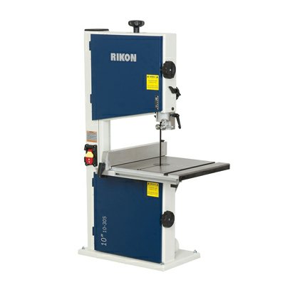

I've been looking to buy my first bandsaw. I'm making pens for the most part, but as well as other woodworking projects like bowls, cutting boards Ect.
So I have around $300 to spend. I've been researching for a few weeks. The ones I like the most would be...

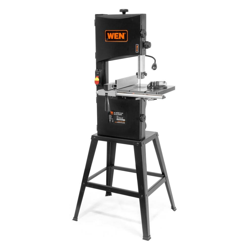

WEN 3962 10-Inch Two-Speed Band Saw with Stand and Worklight

RIKON 10" Bench Top Bandsaw, Model 10-305
https://www.rikontools.com/product/10-305

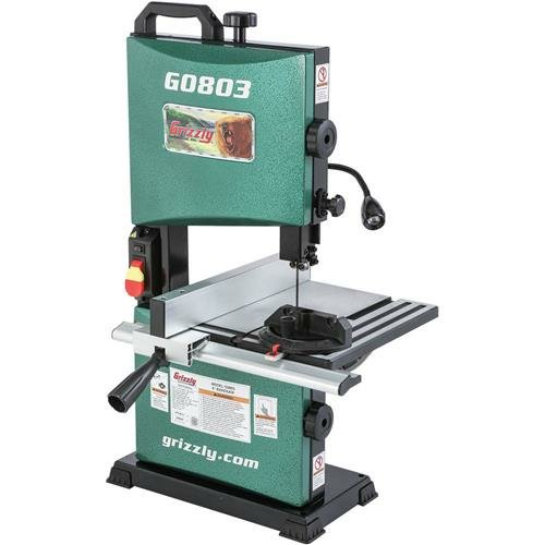

GRIZZLY-G0803 - 9" Benchtop Bandsaw
9" Benchtop Bandsaw | Grizzly Industrial

I have the Wen that you are showing.Had it for almost 2 years as long as you know it's limitations go for it. It is easy to adjust the guides and install blades i keep a Bi-metal blade on it for almost everything I cut all of my blanks and tubes. 2 things you do not want to cut are Stone Blanks and Seashell. If I want to cut something large than I switch to a 1/2 blade You can,t beat the price. Now if you are going to resaw large logs forget it

Those may suit your needs, however my advice would be to consider waiting until you can afford to buy a 14" saw. If you just don't have the space, I would say go for the Rikon as their support is some of the best.

The latest issue of Wood magazine has a bandsaw review. The Craftsman 14 inch (a Rikon, I think) got the best tool award. The Rikon got the best ten inch saw.
I have the Craftsman Rikon and it works well, I recommend it. But consider this., if you mount a ten inch saw on its own stand you take up about the same room as a 14 inch saw.
