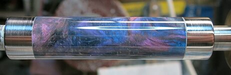

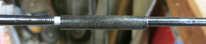

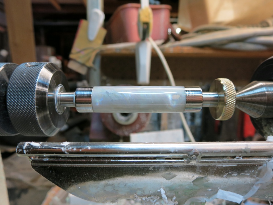

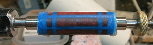

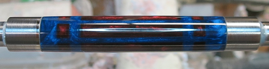

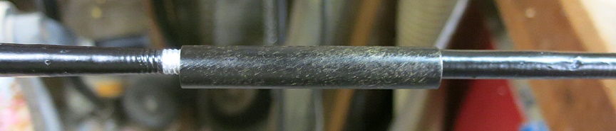

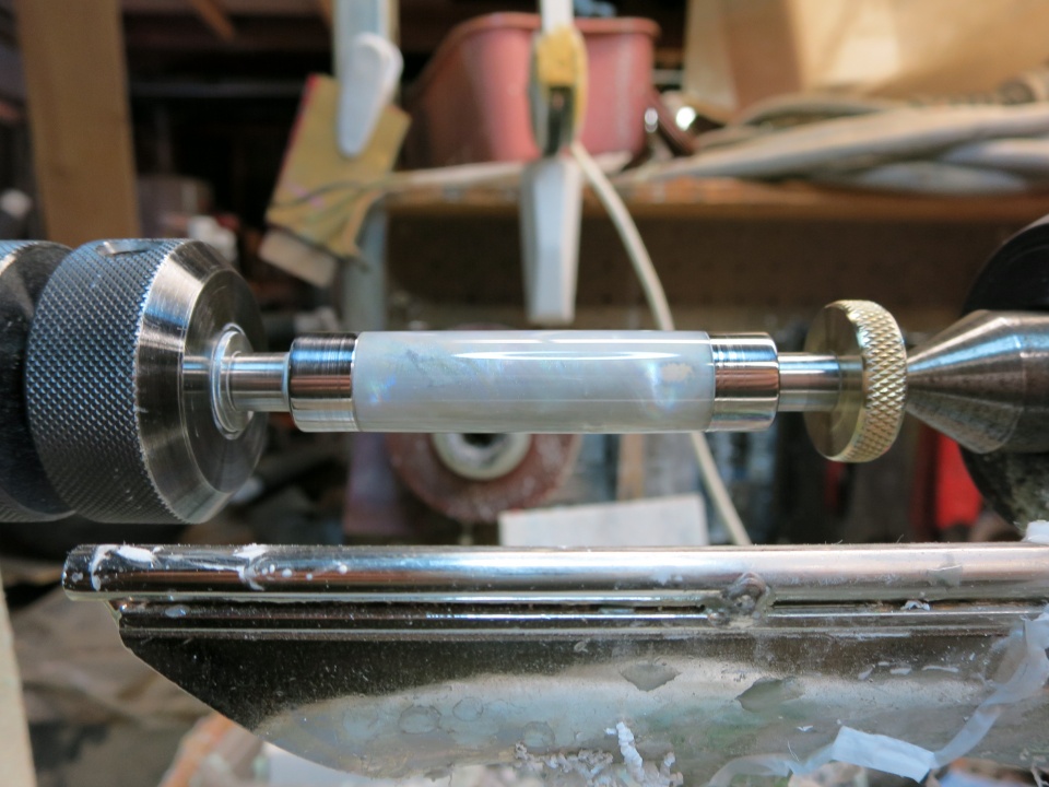

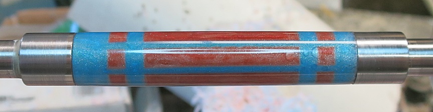

I've been working on my first (and probably last) Wonder Windows blank from Exotic Blanks. I figured out how to cut it, center it, turn it round, and drill it centered. I had a feeling it would be translucent, so I knew I'd need to at least paint the tube and color the epoxy. I didn't want to use red or blue, because I was afraid either would give the blank a purple cast. And I was afraid white would lighten it too much. So I chose silver. Bad decision. You can clearly see cloudy silver in the red "windows". I still have the other half of the blank, and I think I'll use black on it, even though it might darken the colors. I don't know what other color to try.

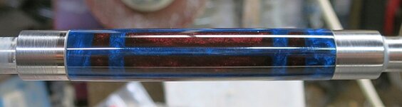

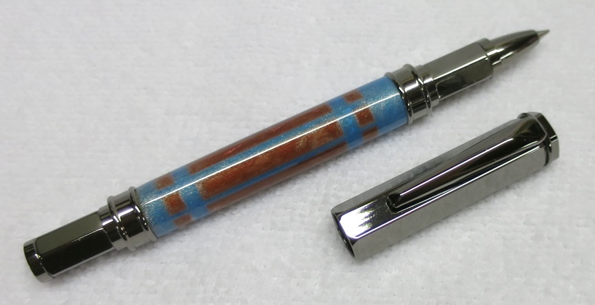

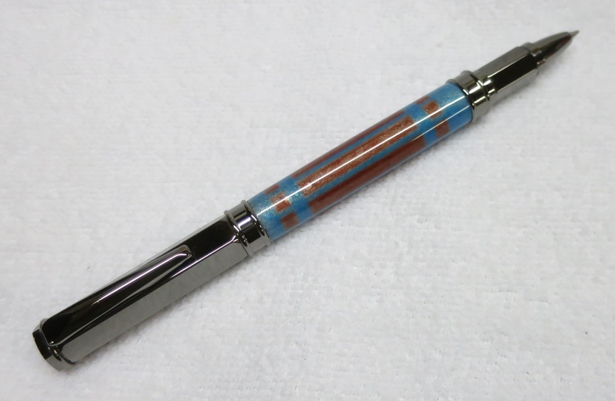

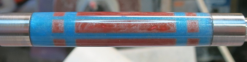

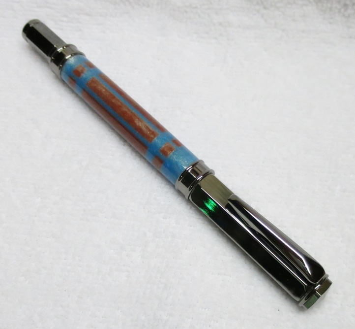

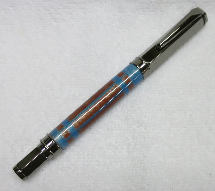

I'm just not happy with how the blank looks. The colors look pale and washed out.

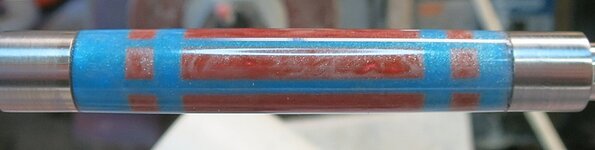

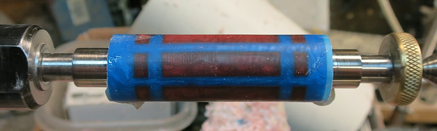

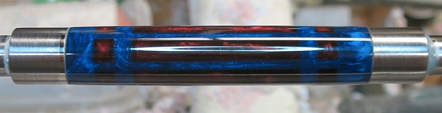

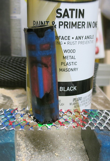

I'm hoping the black will make the colors look darker on the second attempt.

I have to ask.
Is that bubbles in the resin?
In the first group of photos, I assumed it was water drops, since it appeared you were in the finishing stage.
After seeing the assembled photos, those spots remain and I was curious.
qquake
Feb 8, 2004
5,023
Northern California
I have to ask.
I think that's the epoxy showing through.

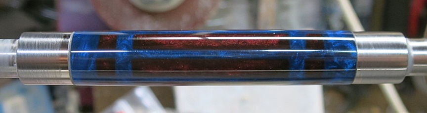

Black is ALMOST the universal answer for back-painting blanks...but we tend to seek something else from time to time, before returning to the right answer!! :eek: :eek:
qquake
Feb 8, 2004
5,023
Northern California

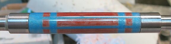

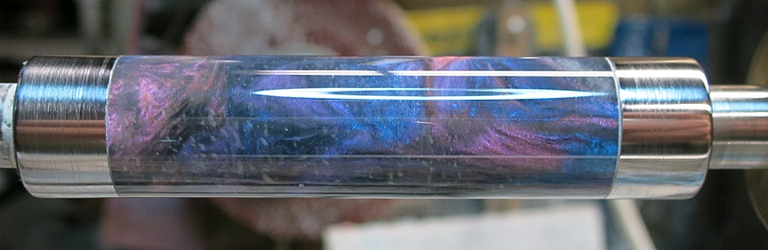

I've actually run across this before with some opalescent blanks. I should have known. The first one is an Opal Swirl blank with silver paint. The second is an Angel Wings blank with black paint.

I'm so glad it worked out. It is so strange to me that black would be the best color to back paint, even with light colors. I know it to be true, but it seems so crazy!
Lewis
Smitty37
Passed Away Mar 29, 2018
In Memoriam
Nov 23, 2009
12,823
Milford, Delaware 19963
Lewis
Well not when you think about it. The color you see is reflected light...black reflects fewer light rays than any other color so the colors you see will be coming from the blank not the back paint.
qquake
Feb 8, 2004
5,023
Northern California
I've never heard it explained like that, but it makes sense.
