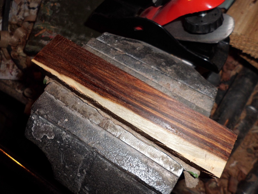

LOL .... staring at the forums and subforums for 5 minutes, wondering where I'm supposed to go to ask what kind of wood this is ... That's just rediculous! :)
Anyways ... as some of you fine folks know by now, I and several others suffer from effects of sensitivity, specifically towards problematic woods like Cocobolo. The oils can cause rashes and other allergic reactions, and the dust can carry these oils all over the place.
I do have several dozen examples of Cocobolo here to compare this piece to, but I can't be sure of what it is, as I'm just not familiar enough with all the various woods it COULD be... so, I asked the person who sent it, but there was an unusually cryptic code written on the blank's sticker ... THMBOT1
I went ahead and took a few shavings with my little block plane .... made sure to wash up right after, of course!
It's beautiful .... hoping it's NOT Cocobolo, but I have some here with a similar creamy colored sapwood attached to it ...
It's coloration is fairly close, the weight is very close, and the hardness of the wood is also extremely close.
attachment.php
The sapwood is very lightweight stuff ... almost like pine... just like Cocobolo sapwood.

Tamboti has an incense like odor. nothing like cocobolo which is a member of the rosewood family.
If you have alergic reactions and there is a question, swap it for a different blank, or at least be sure someone is around to use the epipen or call 911.

That can be many different types of woods and when people ask that question they show a small sample such as this. Who knows but i too put it in the rosewood family.

I was going to say that, "if it smells like a duck, flies like a duck and quacks like a duck, there's a good chance it is a duck...!" however, the pics of the Tambootie did look a good match also to the code in the wood.
I have a couple of woods that look like that, the best one is the Australian Mahogany but I/m sure it is not it.
A wood identification forum..? do you have any idea of the monstrous task would entail? there is already so much material online and even though, I have a hard time identifying some of the wood's I find, there are far too many wood species in this world that look identical however, from very different wood species.
As for woods that will give people some nasty reactions, one of the easiest ways to find out if you are allergic to it or not is to sand/plane clean a piece of that wood and rub it on your under arm where the skin is more sensitive and wait a few minutes, if a red rush will appear, that indicates you are allergic to it, wash that area well and then apply white vinegar, the irritation should disappear within 30 minutes.

If you are lucky, you will not have the rapid change from rash to having your breathing affected. Alergic reactions are not very predictable once they start.
Good luck, but invest in an epipen if you are going to persist with rosewoods.

Look at all the rosewood photos. Could be many.
The Wood Database
Paul Hinds is the guy behind the Hobbit House wood id site. He answers many questions on the Wood ID section of Woodbarter.com.
In order to get an accurate ID, it is necessary to see the end grain in clear close-up - - he has hundreds of examples of what this means, but to give you a hint: rough sawn won't be good enough, you have to sand it to perhaps 400 grit.
If you really want to know what your piece of wood is, Paul is your best bet.

The Forest Products Labratory in Madison Wisconsin will do a few samples a year per person. The FPL web site has instructions on how to sample and send. Just takes a small amount. They are world known experts and are paid with tax dollars.

Thankfully, Clayton (who sent me the blanks) came back with a positive ID on the Tambootie!
This is gorgeous stuff, and up close it really does look and feel like Cocobolo ... if I can turn this with no problems, I will certainly look in to obtaining more!
