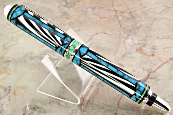

Not gonna rush, but I should have it done in a few hours. Maybe. This'll be the first with my metal lathe, now that I think on it.

You can. I've done this one before. That's why this is a "redux" ... This one will be a little more precise and will not require a CA finish, because the black veneer is all Onyx acrylic. Also, this time I will keep the bigger pictures I take of it.

Problem solved. Here it is capped.
This one is cleaner in many ways compared to the first one I did. Every mating surface and / or thickness critical piece was faced (trimmed / milled / sanded) to within .001 using a mini-thickness sander. Very boring work, I must say. But The results speak for themselves.
Turned it on a mini-metal lathe and I like that way of doing it.

Awesome as usual! Can you give more info on the "mini thickness sander"?
One of the Byrnes machines. You'll need a perfectly milled pushbar/ platform and doubled sided tape to make it work. But I used it to clean up everything, even the blank itself before cutting.
The thing I like most about this pen design is how the Zebra stripes create optical illusions.
