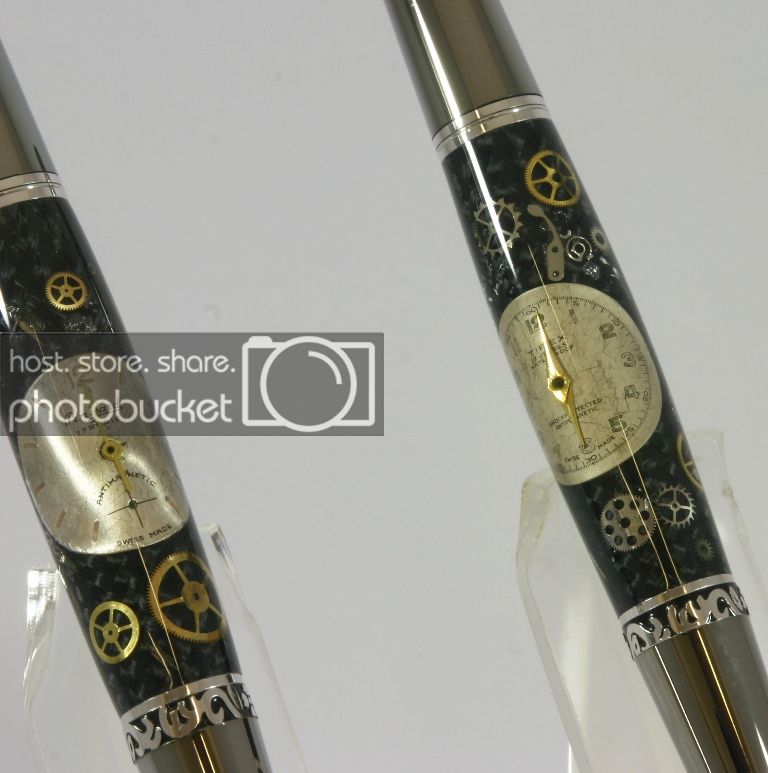

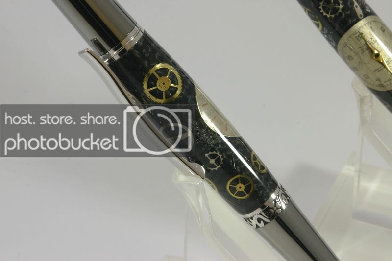

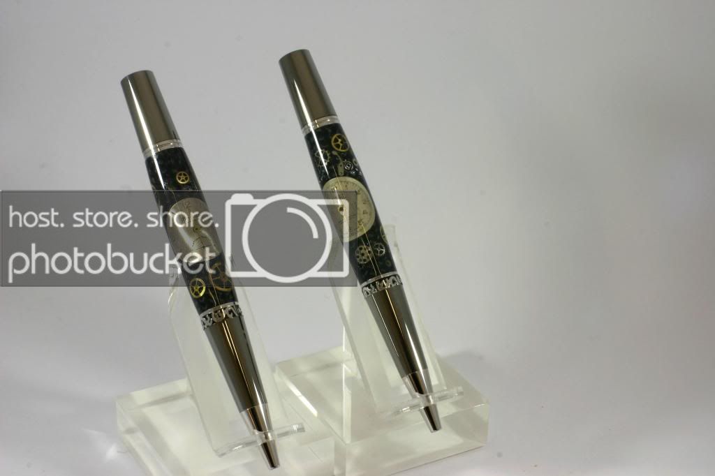

After turning one of Marla's great watch part blanks I wanted to have a go at making them myself.
For a first go I think they are so so!
First problem was how to get the carbon sleeve on to the tube, and decided to use clear epoxy....first mistake! What looks like air bubbles is in fact epoxy.
Second mistake was hand bending the parts to go around the tube....a couple of them cracked.
Third mistake was not enough light to see by so consequently didn't notice one cog ended up almost at right angles to the tube so it got snagged when turning.
Next time I intend using the same resin to put the carbon on the tube and also to glue the parts on. Also going to make some kind of former for the parts.
Any suggestions will be more than appreciated!!!:)

Interesting process for sure.
Never turned one of these pen before, and maybe it's just me, but the band closest to the nib looks incomplete. Like it's missing a small band in front of the decorative accent?
Either way, great looking pen and really cool blank.
Cheers Chris.
I see what you're saying about the accent band. This is the new(ish) Lucida kit from Timberbits. The plating seems to be really good, and at a bargain price too!

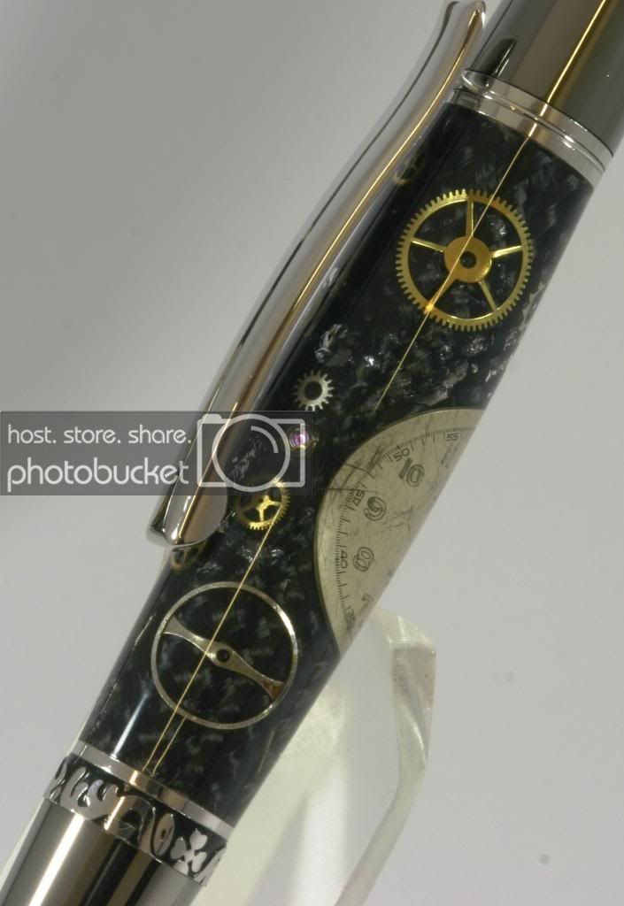

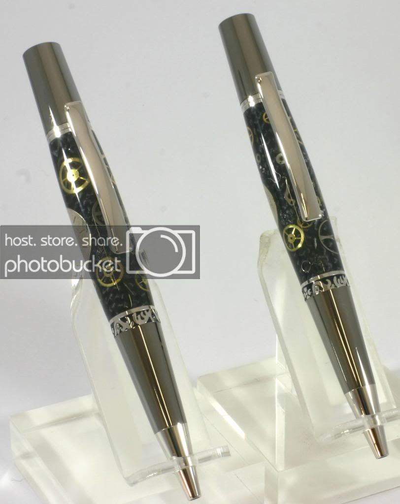

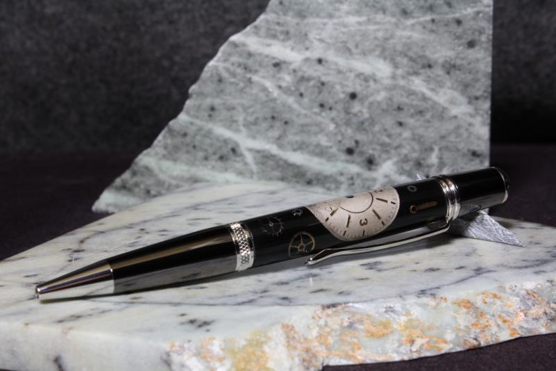

I have been reading the forums here for a while, but this thread is the one that prompted me to join.
I have made a few of these pens, and have just bought more dead watches to make more.
I heat up the gears with a candle and them bend them in a form I made using hard maple and a round piece of metal. Once I have it to the right shape I use a tiny amount of epoxy applied with a tooth pick.
I paint my tubes to give myself the most clearance I can.
For thicker pieces, I use a file to file them thinner so there is no chance of turning past the resin and hitting the pieces.
I also like to use the back plate of the watch with the company name on it and it usually has a cool design on it as well.
In all reality, the only thing you an do is experiment to find what works for you.

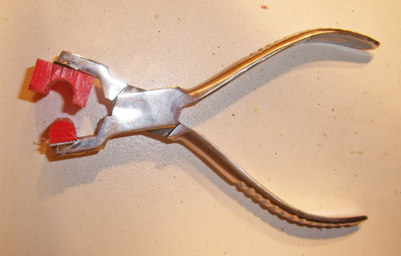

I make my blanks by using a thin layers of PC and press the watch parts into it. They stick pretty well and Ok when the pC is baked. I then coat the blank with a few coats of clear acrylic paint and leave to dry completely. i then coat the blank with PR using a paint brush to ensure I get all the nooks, prior to casting in a resin saver type mold, no pressure.
As far as the watch parts, I bought a watch pin bending plier that has teflon guides screwed on (off Ebay), but not the right shape. I then make my own guide using some cutting board. I have attached photo of finished pliers and how I make the guides.

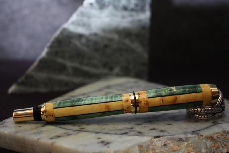

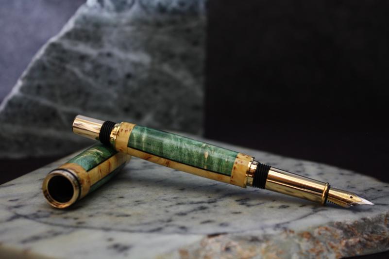

Also, John T. I love your ebony and holly pen you posted on lumberjocks. Thats the pen that inspired me to start segmenting. It inspired this pen, made from yellow cedar burl, dyed green stab maple burl and black veneer.
View attachment 88337:
Jeremy
Thanks for the kind words. I do hope to eventually get a few more out there to show. Time is not friendly right now.
May I suggest you show this pen in Show us your pen forum. It deserves to be seen by many.
