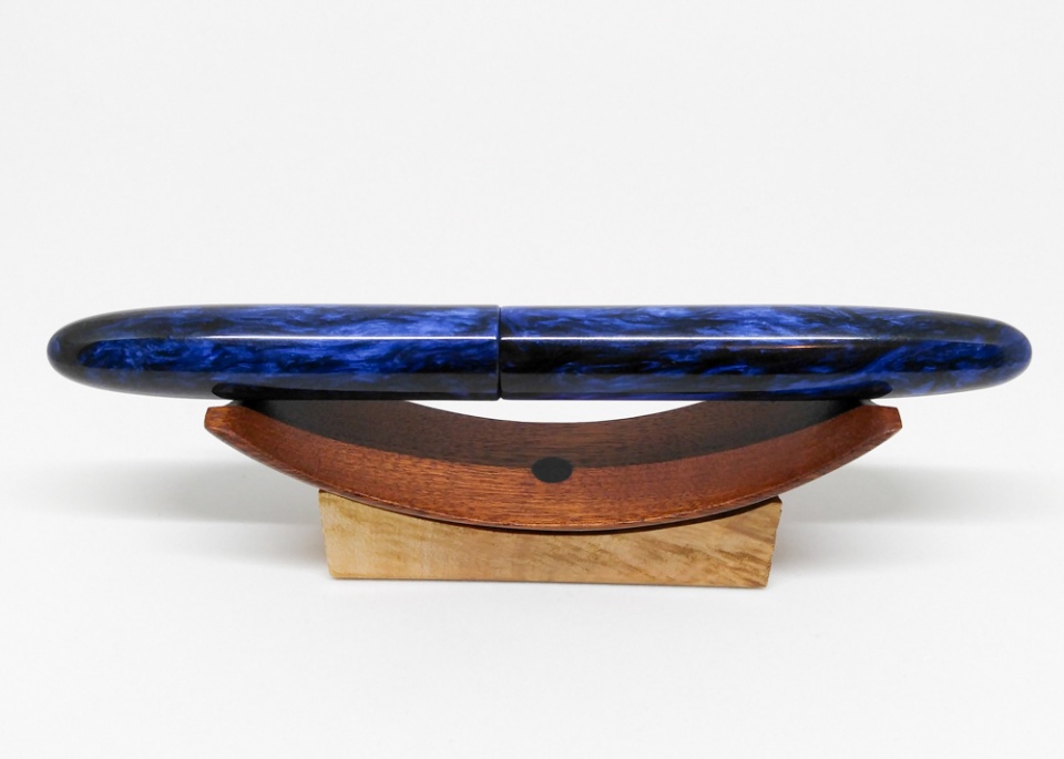

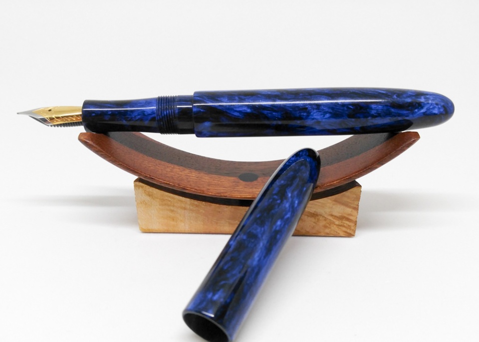

Here are the finished shots.
Regarding the lathe, it's the Weiss WBL50F so yes, just about the same machine as the PM1030.
It's heavy and I personally wouldn't attempt stairs at the risk of dropping it. But that said, it may be doable with a good appliance dolly well strapped in. I used an engine hoist to pull it from the crate and get it on the stand. It's a heavy SOB but not unmanageable.

Beautiful! I'm a sucker for blue pens. If you were to add a clip, would you account for some kerf and cut off the end of the cap? Great job!
Sent from my iPad using Penturners.org mobile app
Adding a clip would add about 5mm in length to the pen to accommodate the threaded tenon and nib clearance. If I planned a clip at the start I could have been more accurate with my cuts and gained that length out of the same blank. i.e. use my bandsaw to cut/part rather than the parting tool. Saves a bunch of material.
