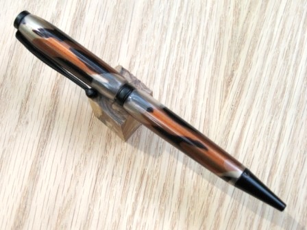

I`ve used them and they did fine. I actually used them to cast the arrow shafts in this pens.

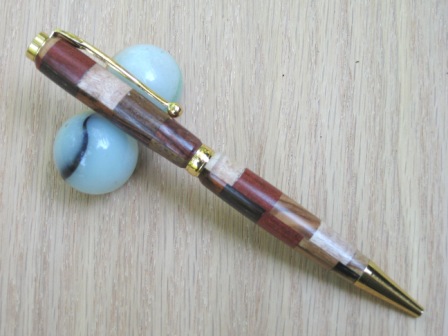

Scott, I`m sorry but that is not a cast pen that I posted yesterday. :eek:This is the photo that I tried to post .......Sorry :biggrin: Yeah that`s the correct one.
