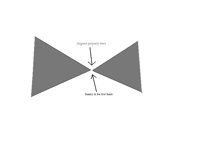

I don't want to hi-jack the thread, but on my own lathe as you look in from the front they align perfectly on top but the live centre appears to be below the dead centre. Would this cause any problems?

Here's how my lathe appears.
On a wood lathe using handheld tools, you won't notice it. If you're turning cylinders on a metalworking lathe, you *will* notice the taper.

If you are using a standard mandrel, those two points are about 8" (20cm) apart. It will make no measurable difference---IMO---Several machinists here would be better authorities on this question, however.
Would it would be ok for turning between centres? I have the live and dead centres for tbc and a mandrel also.
Yes, it will be fine. On a wood lathe *you* control the cutter with your hands, and turn either to the bushings or measured diameter with calipers. Unless that offset is huge, in which case you'll be wearing the center indents on the mandrel or the centers' points faster than normal, it should cause you no problems.
