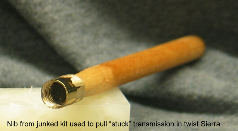

For the price of the cheapest Sierra kit ($5-6?), I used nib threads from a kit and epoxied to a dowel. Seems to work ok.

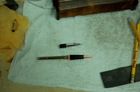

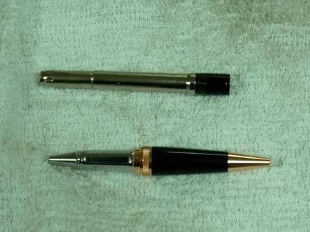

Here is a simple solution, pictured are the copper wall street with transmission and the front section of a Navigator/Baron the second picture shows the transmission from the W/S switched with Navigator/Sedona nib pieces. If you press the plastic piece into a 10mm tube, either from the Navigator kit or a cigar tube, it will fit right up inside the tube of the wall street. It may cost you the price of a Navigator/Sedona kit if you dont have the spare pieces laying around.
That's the best tool, then use just a small drop of blue locktite, or even elmers glue to stop it from unscrewing again, you can still get it loose just requires a bit more effort. I love that pen but quit making them for the very reason they come back too much.. also try the Dayacom Elegant beauty a tiny bit smaller, but way better transmission system and they really are beautiful one piece pens.
