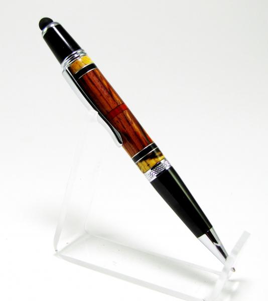

Hi All,
My Brother-in-Law brought me a WS II stylus pen I had made him over the summer.The stylus nib has been torn completely off.To repair his pen and get it back in his hands I just replaced the entire top of the pen.This would prove to be a very costly repair as I had to use the top from a new $10 kit.
Does anyone have a suggestion on how to possibly repair/replace just the rubber?
Also what type of fabric/rubber is needed and where could one purchase such a thing?
Pic is of the completed pen last summer,I can photo the damaged end if need be.
Thanks!!

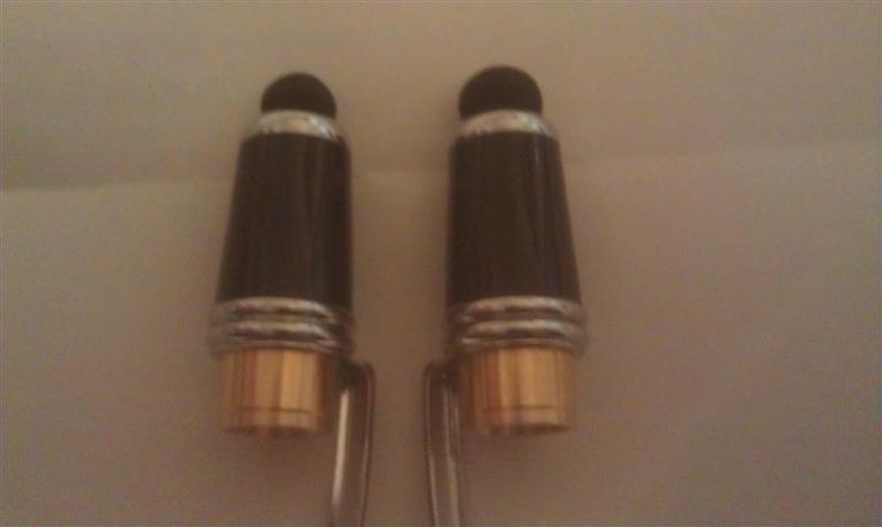

In an effort to help answer my own question,I ordered the Mesa stylus tips from Woodturningz.
Today I disassembled the offending tip in the WS II and replaced the stylus with the new arrival.
It does work,seems to be a softer,more pliable tip and is a bit larger.
It may be incorrectly installed,there is not alot to see/fit when assembling or could be bigger than the OEM stylus tip.
I was not going to disassemble a kit to find out.
Pictured below is the original OEM WSII on the left and The Mesa stylus tip on the right.
Ed at Exotic Blanks has Sierra replacement tips,soon to be a stock item ,and I will try one of those with my next order from Exotic Blanks and report my findings.
