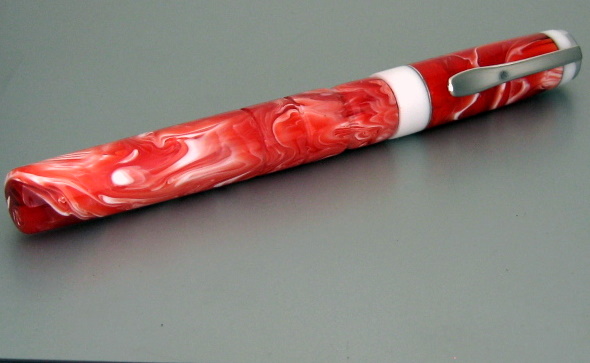

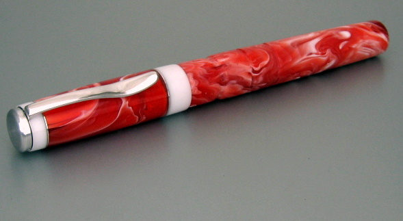

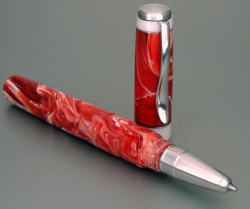

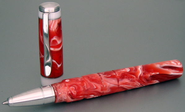

Got this nice blank from Jonathon Brooks. Aluminum nib and finial. The clip came from Jon Piper (Good Turns) Thanks Jon & Jonathon! This blank is alumilite and turned very nicely. Thanks for looking!

Pretty, but I have a question:
In picture one there are two distinct parallel lines. Are these grooves in the pen?

Thanks! Very good eye!:biggrin:
Looks like three grooves to my eyes
Even better eye! The lowest one was an accident that occured when the blank climbed on top of the tool post. I smoothed it out and cut two more so it wouldn't be lonely :biggrin:

Looks better than I imagined Chuck! I agree, the white really sets it off. It paired well with the aluminum too. Not to mention the perfect finish. Did you do any reverse painting on this?

Thank you Jonathon. Gotta do something different with the finial. Yes, I did paint inside the cap white. Good work on the blank. I like the way you can see thru the red, and view a white ribbon inside.

I like the details your putting on the nib. For the finial you might try cutting a relief in the top and inlaying a piece of the blank. Keep up the good work.

Thank you Mike. Do you mean use a piece of the blank as opposed to the aluminum? And, by relief, does that mean recessing the end with the mill?

you can use an end mill to make the recess or you can turn your tool holder 90 degrees and cut a recess in the top of the aluminum to glue a piece of the blank into. the pictures show what I am trying to describe for you. Instead of wood use your alluminum cap and a piece of the blank.

OK, now I see what you mean. That would be really nice too. Thanks Mike!
