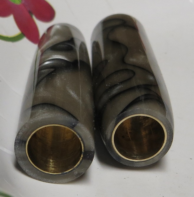

Made a rookie mistake tonight. I searched here but couldn't find any similar threads with suggestions.
I was preparing an acrylic blank for my first attempt at a cigar kit tonight and just completely forgot to paint the tubes. Didn't realize it until I came back into the house. Went back out in the slim chance that the epoxy had not set up but no such luck. It had hardened enough that the tubes were locked in.
Do I have any options here or will I just need to pay the stupid tax (cost of blank + a new set of tubes)? Can you drill out brass tubes and just start over?
Any veteran wisdom would be much appreciated!

Some blanks will not show thru and some will. I have also seen some comments on here where people even like to see the brass tube through the blank. By the way, I have never made made that mistake.:smile-big::beat-up:

Yea the only reason I was going to paint the tubes is that you can already see the brass color even before turning. Never had one this translucent before. Only going to get worse as I turn. Guess ill just give it a go and see what happens.

Painting the tubes different colors gives the barrel a different look. Now you will see what the it looks like as if you had painted it brass colored.
May look fine, might even give you an interesting look.

The Cloud 3 has very translucent portions ! ... So you are certainly going to see the brass tube more and more as you turn.
Not much you can do about it.
In my opinion, seeing the epoxy is even worse than seeing the brass tube. . That's why painting the inside of the hole is so often recommended.
I doubt you can drill out the brass tubes successfully ... unless you did your drilling on the lathe and you now attempt to drill out, again on the lathe, with a drill 1/64" over the size you previously used and then put in 2 or 3 thick coats of paint into the hole.

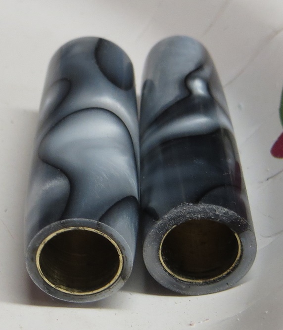

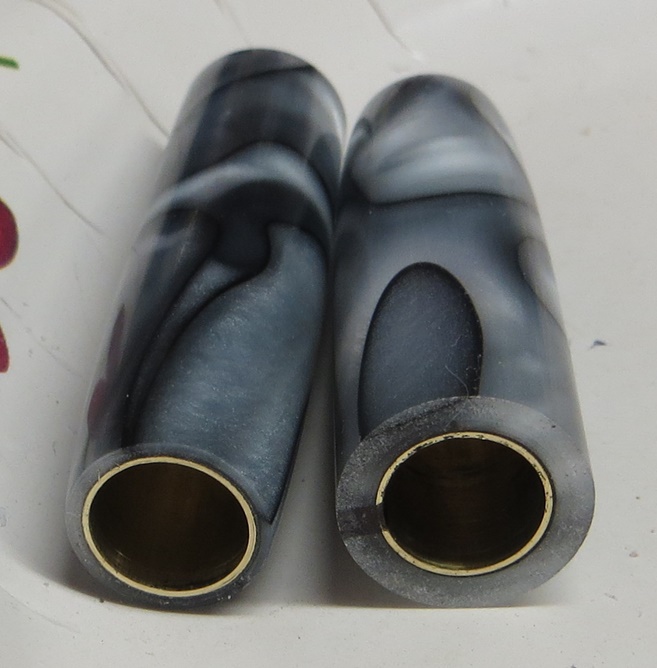

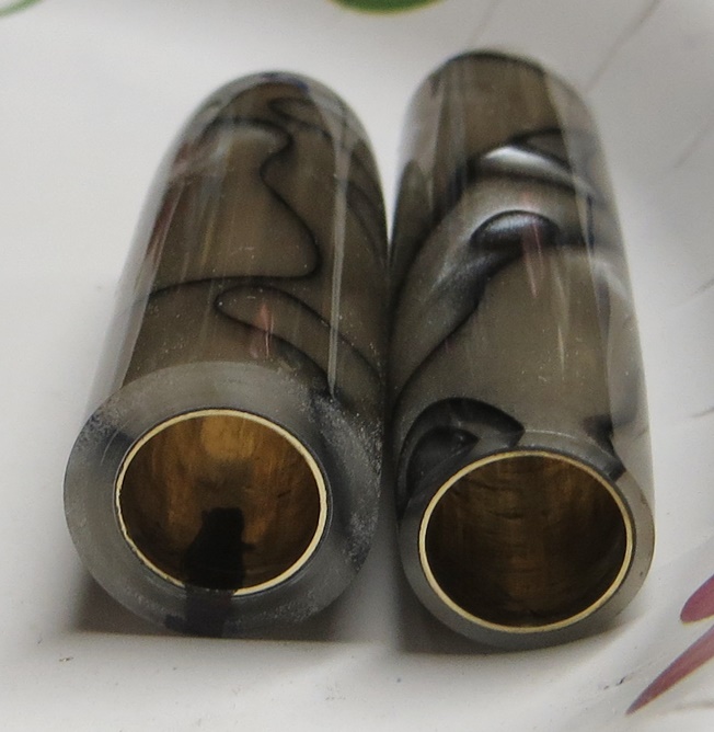

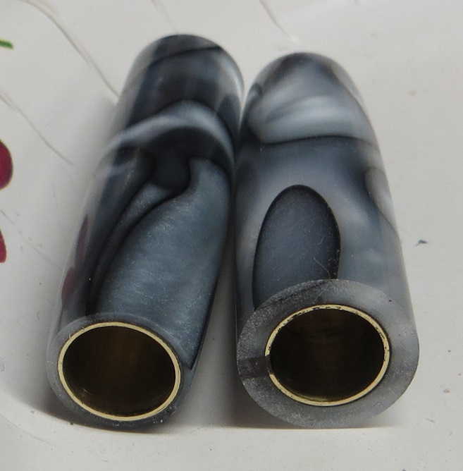

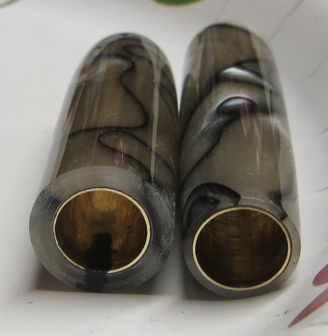

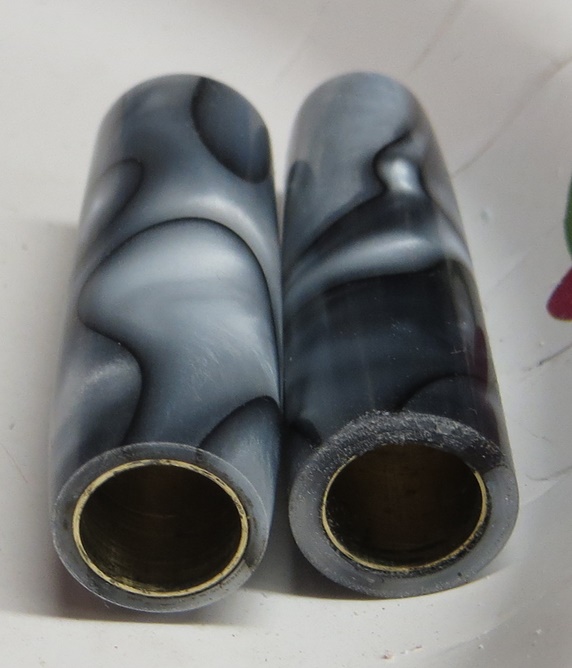

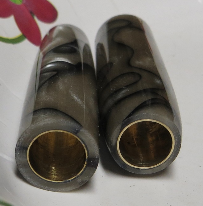

I'd be afraid the acetone would soften the blank, too. If you have a cutoff piece of the blank, you could put it in some acetone to see what happens. But I would go ahead and turn both bodies to see how they look. Portions of the Cigar pen bodies are pretty thick. They do get thinner towards the finial and nib ends, but not as thin as some other pen kits.

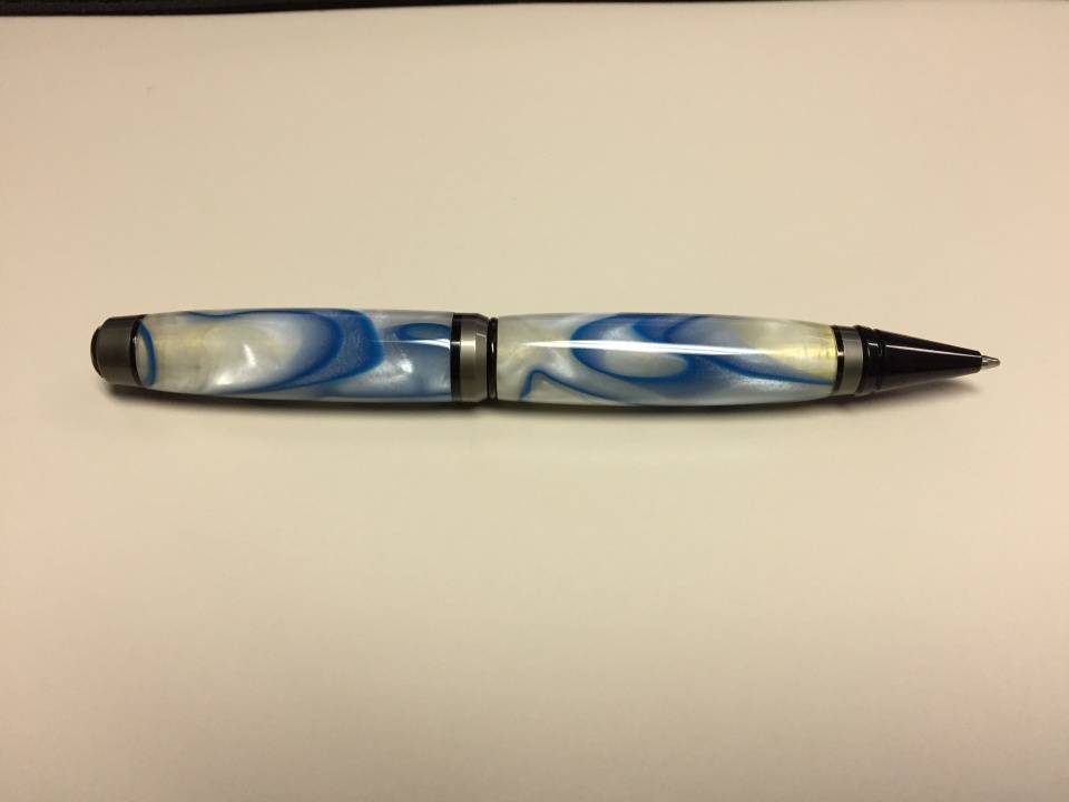

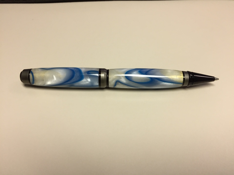

Finally got around to turning this one over the weekend. Not thrilled with it but probably more to do with my expectations for myself rather than how the blank actually looks. Cigar may be my new favorite kit though so that was worth it!
