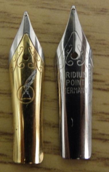

I made a Vertex fountain pen kit, and upgraded it with a #5 Heritance nib. But the nib seemed loose, so I went back to the one it came with, and that seems nice and tight.

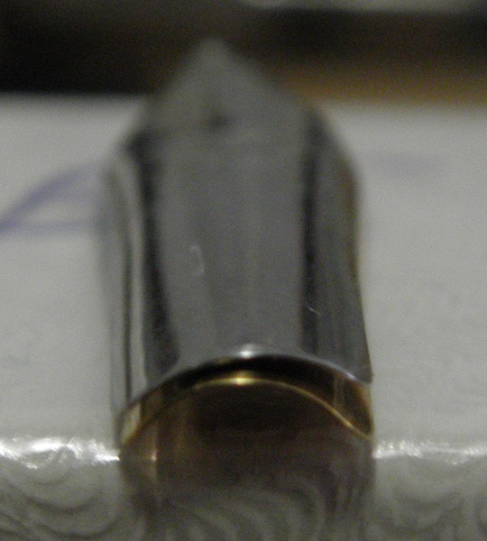

The nib looks the same size as the #5 nibs I have, so I don't think it's a #6, although I've never had a #6 nib before. Are #6 nibs obviously different widths, or is the important part the radius of the curve?
Here's a front view of the stock nib and the heritance, side by side, and an end view. The heritance nib is the gold plated one. Note that the stock nib has a visibly larger radius, which would explain why the heritance nib was loose.
So, does the Vertex take a #5 or #6 nib, or is it non-standard?

been there... I now inform any buyers of the Vertex fountains that the nib on it is the nib you will be using! I thought a #5 would swap in and have tried several brands...they are all loose (to the point of falling out).

NOT knocking the Heritance nib OR the Vertex. My experience (somewhat limited with Vertex) is that the Schmidt nib fits better than any of the others.
The Schmidt can be bought as a complete front section ( I forgot where I got these, but an IAP vendor). By replacing the entire assembly with Schmidt, it is THEN easier to get a precise nib fit on the Schmidt feed with either Schmidt, Bock, Heritance, or Dayacom nib.

The Vertex has a known issue with ill sized feeds. No other feed really exactly fits this pen. The Schmidt was the closest fit I could find and IIRC I had to run a tap through the section to make the Schmidt feed fit.
There IS a way to flatten the rear of a Bock/Heritance nib to make it fit better. I'll leave this explaination to Brian Edison, Mike Kennedy (IPD_Mr), or Anthony Turchetta. The way I adjust these is sorta "rigged" when using the existing feed. These guys can give you a better, more scientific fix, rather than a "jury rig ".

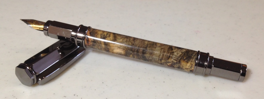

I think I'm going to just leave the stock nib on the Vertex. It seems to write fine to my inexperienced hand. And it looks better, I think a gold nib on a gunmetal pen looks odd:

It seems that there are some of the Berea Hardwood component sets that the feed and housings are of a different curveature than some of their other components and are different than all of the CSUSA and PSI has some also (vertex) . I've also had customers with the Rinehart with the same probem, the Heritance, Bock, Schmidt and Edison all are loose fitting. There is nothing wrong with these kits other than no aftermarket nib will fit properly. With these component sets the nib you get is the nib that will have to stay. A little tuning might be in order while not a fix all it will write better if tuned (as all nibs will).
