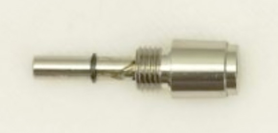

I've made a bunch of the vertex clickers. Several for myself and a bunch that I've sold with zero failures from actual use. One brought theirs back saying it wouldn't work. Turns out they did not put the spring back in when changing refill. One of mine broke when it flew out of my pocket and landed on asphalt. But if I drop any of my pens and ding up parts then I take them apart, refinish them and put new parts on them. So bottom line.... They are a good kit that I would not hesitate to sell for their given price point. You want the most durable click mechanisms? Then go kitless and use the one I use from Richard Greenwald. Great feel. Really smooth and no loud clicking noise.
Thanks Jeff - you are not the first to suggest the mechanism from Richard. I've made kitless Fountain Pens and roller balls but no clickers as of yet. Can you advise if there is any special tap and dies needed to use the referenced click mechanism from Richard? His web site doesn't give much info.
Thanks to all for your responses:)
The only tool you'll need is a 7x.75 tap for the mech. Since you're doing custom FP's and RB's you should have everything else. Here's a tutorial on the process: http://content.penturners.org/library/pens/kitlessclickpen.pdf
+1 on this mechanism. If you're into mass production, this may not be the way to go. But if you want a quality click pen, I don't know of anything better. It's all metal, and no spring in the mechanism. It uses the force of the spring in the nib to function properly. It also now comes in a gold plated version.
