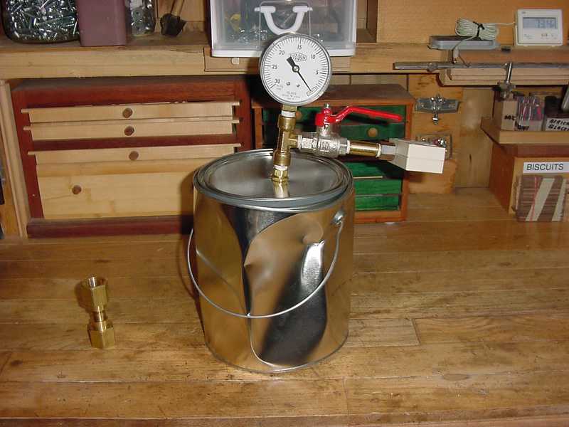

Would an empty 1 gallon paint can serve as a good pressure pot? This is what I have in mind to use as I build my unit. Comments would be appreciated.

Probably not. Assuming that the lid is 6" in diameter there would be over 400 pounds pushing up on the lid with only 15 psi of pressure. This may be hard to hold down and maintain an effective seal. Also, I am not sure how pressure the seams can take before bursting. Then there is the issue of the bottom bulging outward and sitting on a rounded surface.

If it is a nice, clean can, you can use it to *pull a vacuum* but not to use as a high pressure container.
Then again if you were to sandwich the thing between two slabs of 2X6, viced together with really long lag bolts, tighted up really tight, that lid won't go anywhere with pressure.
Uh, why don't *you* try that and then tell us how it worked[:eek:)].

Well, I tried it (paint gallon) as my chamber pot. In a word it didn't work[V]. The tin gallon just isn't strong enough for my little vacuum pump. It collapsed the walls within seconds of me drawing some air out with my small compressor. The good thing is that my fittings and vacuum pump(borrowed from an vacuum lifter) is really compact and powerful. Now I just have to locate a strong vessel that will withstand the vacuum pressure. I'll try the large pickle jar next and go from there. Here's some pics that clearly show my story.[:(]
