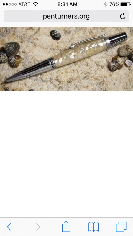

You could also use the sea shell veneer that looks like MOP. There are vendors that sell the blanks. They look very highend.

Not an easy route but not often seen... Buy some shell pieces at a hobby store and pick out the MOP and glue them to a painted tube and cast. I used to make these but the tweezer and ca glue process got old real quick.
