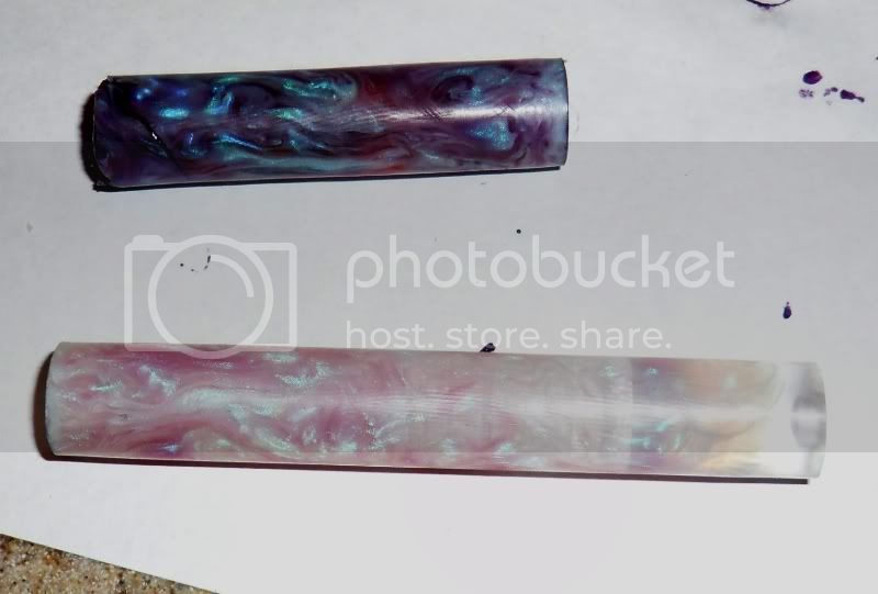

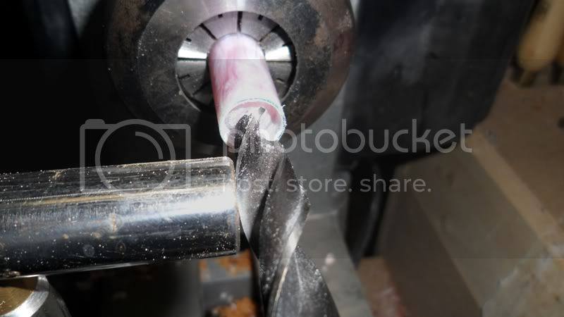

Ok, I tried a little experiment. This whole thread is kinda a result of me trying to drill out a blank turned down to 1/2". I had to do that because I basically cut down a round 1 1/2" bottle stopper into 3rds. The reason why is a different story. Anyway, I drill on the lathe, and only have the basic collets that came with the collet chuck. 5/8ths was too big for the blank, so I had to go all the way to 1/2. I tried drilling the 1st blank last night, and got 75% completed when it got too hot & basically melted. That happened really fast too. So I still wanted to accomplish something last night, so I turned another regular sized blank. This is the one I used the lubricant on. That's why I started this thread this morning.
So after lunch today, I decided to try another 1/2" blank using soapy water as the lubricant. Here are some pictures of the results
The 1st shows the pen starting to be drilled. It's about 1/2 in at this point. BTW, it's for a sierra. If you are wondering about the tool rest being positioned there, it's just to help guide the bit. I've found this helps get the bit started online. I removed it before continuing to drill
The 2nd picture shows the blank (bottom) drilled out deep enough for a sierra tube + about 1/4" extra. I know it's hard to see, but it you look at the right side of the blank, you can see a line where the color changes. This is the depth of the drilling. The other blank (top) was my 1st attempt. I thought I would play with some colors to see how a finished pen might look like. And if anybody is curious, it's a Pua Shell blank from brooks803.
And KenV is right. A good drill bit goes a long way in making things easier. I've been upgrading my bits 1 or 2 at a time. This is not one of them.:eek: It's one thing to use general purpose bits for . . . Well . . . .general use. But I can sure see a difference when I use one of my better bits for drill blanks.

Bob i know this is off topic, but it looks like you collet isnt seated all the way in you collet chuck. The collet needs to be seated all the way to the front off the chuck to be as precise as possible. JohnnyCNC has a video about how to make sure that you collet is seated all the way to the front of the chuck before screwing it on.
Sorry for being off topic,but this could be throwing your drilling off as well.
Justin
I just watched he video & went outside to look at my collet chuck. I think you're right, I was doing it wrong. Thanks for the tip.:redface: I'd watched his videos a long time ago before I actually started turning pens, but I don't remember this one.
I will admit I was doing this blank a little different because it was so thin. I would stop & pull the blank out, so the collet wasn't being compressed on a section that had been drilled. That's one of the reasons the blank was left so long. But that doesn't have anything to do with your tip.
