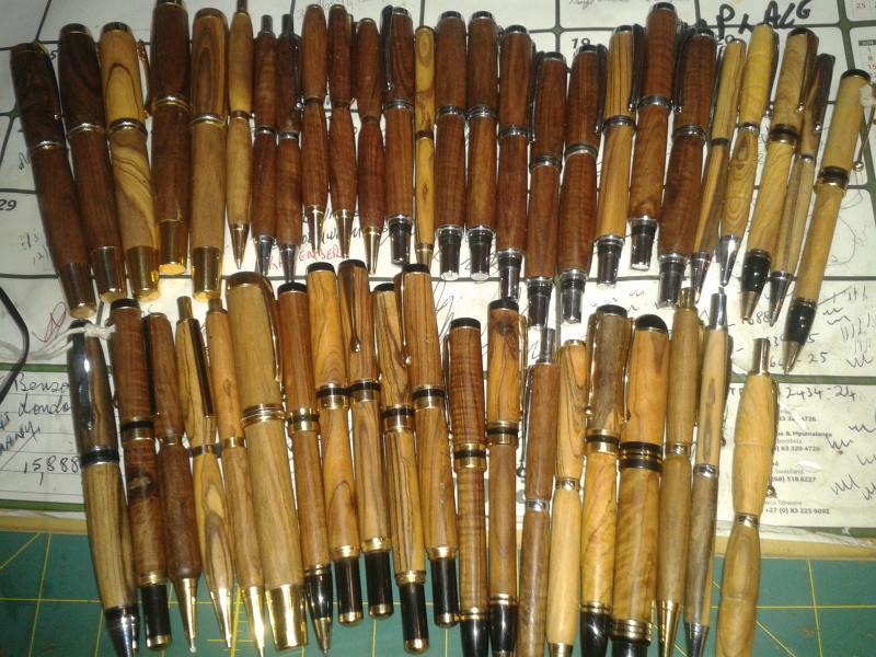

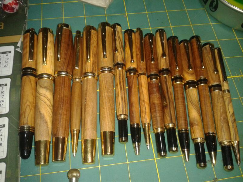

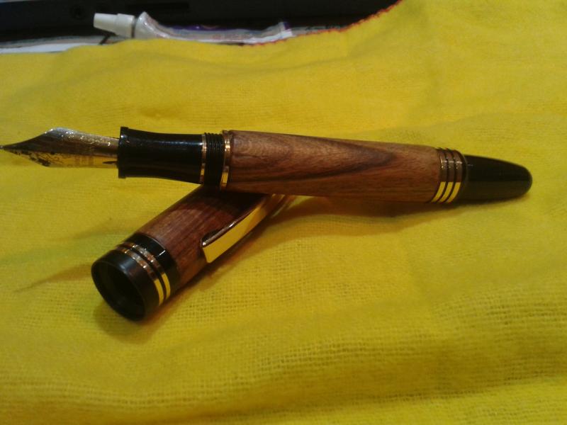

I am an old hand at wood turning but only recently started on pens. To be more precise, I started less than 2 months ago and only work on my lathe after hours i.e. late afternoons and weekends. I have only made 150 pens so far.
What bothers me is the use of CA as a finishing product. I started as a kid with woodwork under the guidance of my late father. He had a saying that if you paint or apply any coating to a product, you are hiding your mistakes!! Therefor I only aply either a special oil developed for the protection of solid wood furniture or alternatively clear wax floor polish.
In both cases it brings the natural grain and colour of the wood out.
Maybe I am wrong in this case that you aply CA because of your weather conditions, or is it to keep the pen together after finishing it???
