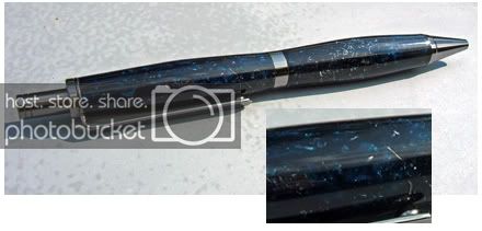

I've done them with brass, aluminum, and copper. I don't have any of the pics on our new computer though.

Here is one with alum. in it.

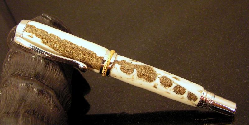

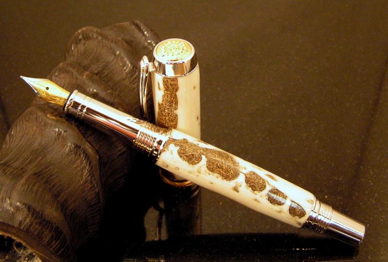

Got a big handful of this brass from behind the key duplicator at the local hardware store. Worked pretty well packed into the voids and soaked in thin ca.
The rest of the blank is gator jawbone. :)

The key brass is an alloy that is easier to use, but not nearly as pretty as real brass. I have used both. Key brass can be ground finer by using a coffee grinder.
I like the real brass better, as it is more gold in color. can be ground finer rather the stringy material I see. Congrats, I see that you worked the inlay properly.
