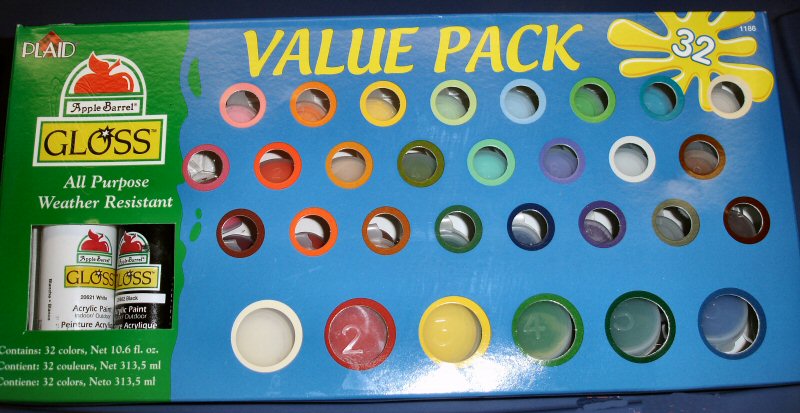

Good source for acrylic paints for tubes
I'm working with the same challenges with tube painting and acrylic blanks. I found a good deal on acrylic paint at ....Walmart! For $9.95, I've got just about any color I'll ever need. And, the paint cleans off with water - no paint thinner like I needed when I tried the Testor's model paints. It dries fairly quickly, too.

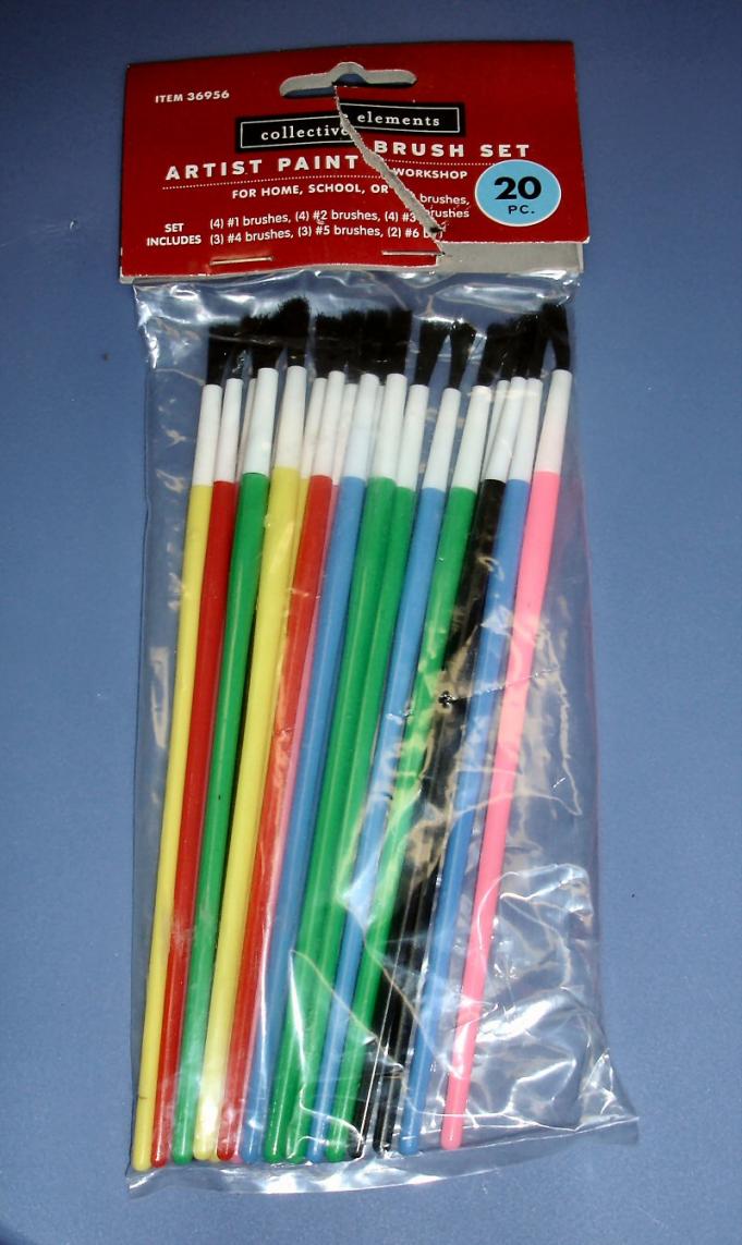

I also found some CHEAP paint brushes at Harbor Freight - 20 for $1.99, and on sale now for $.99! Those should last a while.
I have tried tinting epoxy with paint. Need to try painting the inside of the blanks as a secondary precaution, too. Eventhough the brass is painted, the clear epoxy can show through the acrylics when they are semi-transparent.
I've used Sumo glue, but it foams white.
Seems the three-step precaution would be paint tube, tint epoxy glue ($2 Devcon from Walmart), paint inside of blank.
