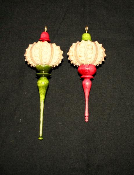

I saw a demo at the GAW meeting last month and this is what we learned to make. They are fun and don't take too long. The largest one is right at 4' tall and both are finished with spray lacquer. Enjoy and comments are welcome. Thanks for looking. Russell

Interesting way to utilize shells....hmmmm
Do you have to cut them to get them squared up, or anything?
The finals just glued on, or something I'm not able to see in the photo?
Great shape to both!
Scott (Florida folks would love em) B

Scott the top and bottom already have a hole in them. I just used a 45 degree stone wheel to "clean" a good shoulder and a good glue point. Then the top and bottom finial have a hole drilled in it for a tooth pick and use that to keep the 2 pieces aligned correctly. The top and bottom finial both have a 45 degree angle cut so they fit the urchin with enough glue to hold the whole thing together. When it is glued up it fits together close enough that you can't see the tooth pick. Hope this helps. Russell

You can also make a long tenon on one of the finials that glues into the other. Make the tenon longer than needed and then trim it down while dry fitting everything.
