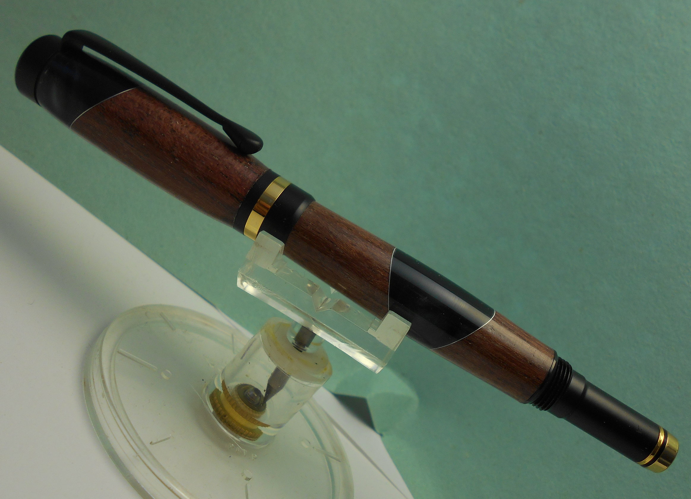

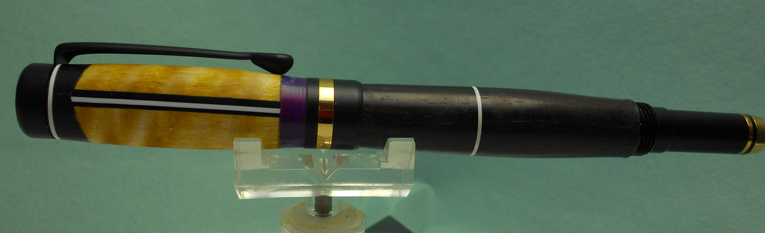

Now you can incorporate both and really take your pen turning to a new level. I suggest you do a little reading on showing smaller photos:):) being the photos are so large and so close up many small flaws show up such as the radial scratches in your sanding method. Need to sand lengthwise for each grit to get rid of those. Need to do a better job with the cutting of the acrylics so as to not get chip out. But all this comes with practice so you are on your way. Good luck. Happy turning and have fun.
Bryguy
Jun 9, 2013
972
New Hampshire
John, Thanks for the comments. I have long been an admirer of your work. The larger photos served me well in this case because you were able to see the imperfections and make suggestions
