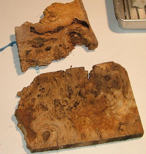

I received a blank of extremely soft Buckeye burl that had been stabilized with Ultra Seal. I had given Charlie-newlondon88 some of this wood because it was too soft to easily save with CA. I rescued it from a burn pile, if that gives you any idea of the condition it was in. I cut it while it was wet and frozen, or probably couldn't have done anything with it. The blank looked as though the stabilizer hadn't penetrated thouroughly, but upon turning it, I was wrong. The shavings dropped nicely, not dusty as I had imagined. Punky looking areas turned as well as solid wood areas. The wood finished nicely, better than normal Buckeye. If home stabilizers can do as well of a job as the factory did with this, Ultra Seal is going to be very popular with pen turners. This stuff works.

Here's a pic of the wood block before stabilizing.
You couldn't really work it at all, it would be like trying
to turn burnt toast. Feels much like acoustic ceiling tile..
and about as strong.
Nice job, Alton.
