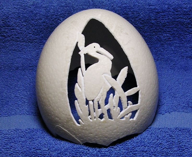

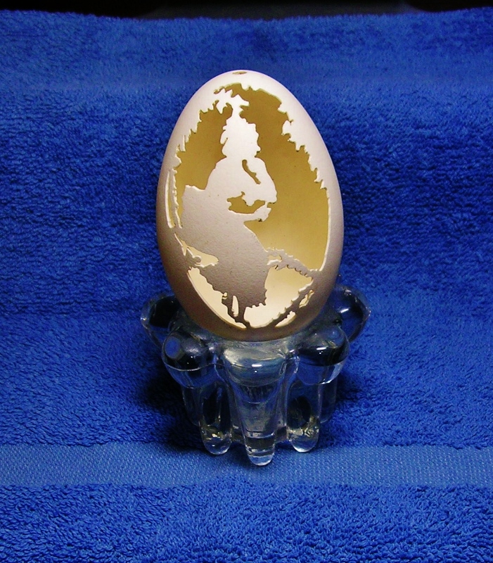

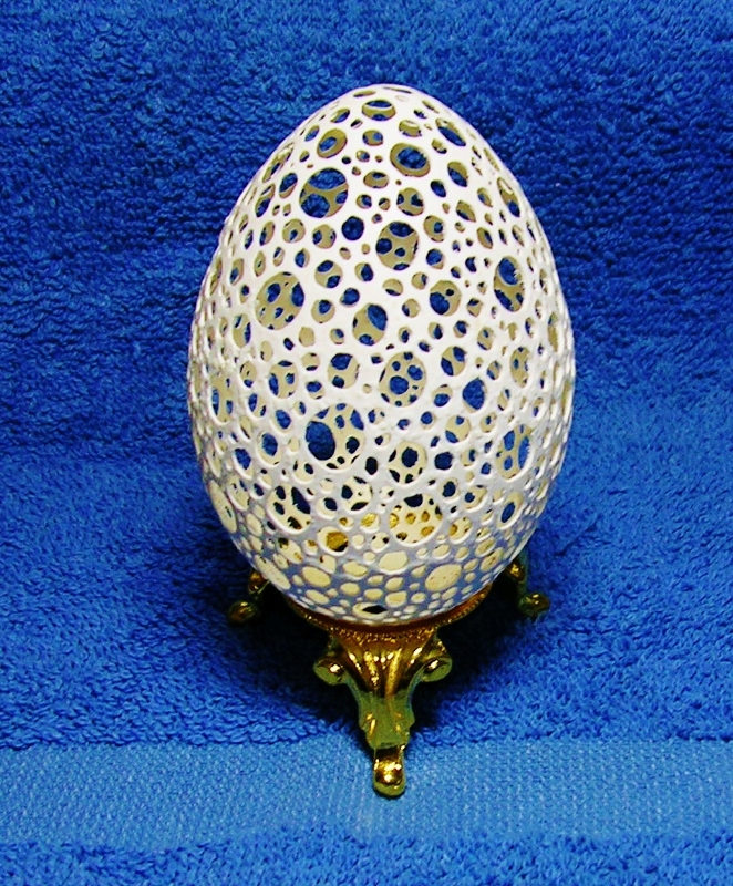

Daniel; I have had a Paregraver for 20 years that I have used for egg carvings, minitures, and fine detail work on woods, plastics, and glass etchings. It is a modified Dentist hand tool with a straight shank, runs around 200,000 to 400,000 RPMS on low (15 lbs.) of air pressure, and uses diamond coated or HSSS burs. It was not cheap !! I have not had any problems with it over the years, and it has seen many many hours of use. Here are a couple turkey eggs, and an ostrich egg to give you an idea of detail. Jim S
