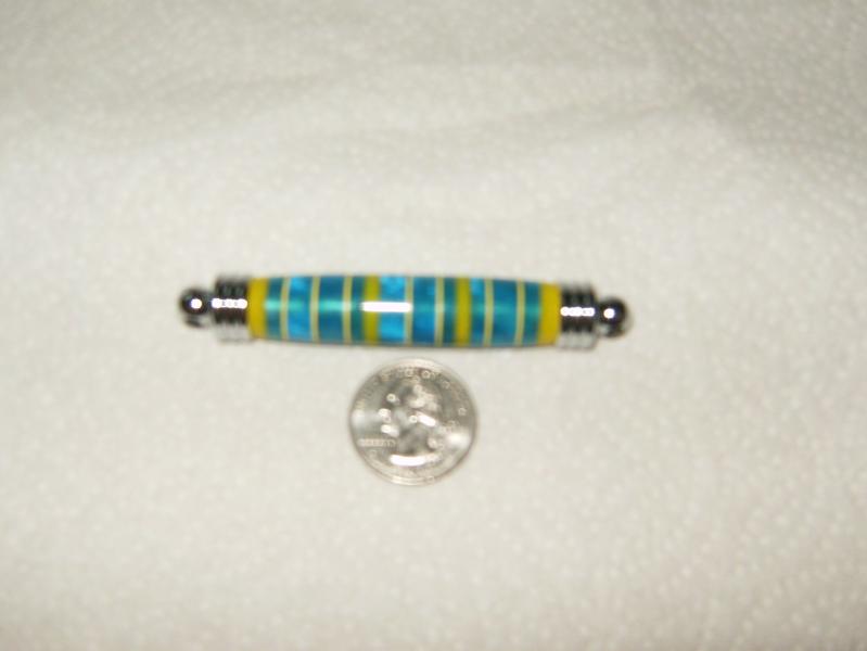

Coincidentally! I needed a piece of material, <1/32", for a project I am working on. To thin for me to cut. I was surprised when I read your message yesterday. I tried 3 or 4 different ideas and for one reason or another they didn't work. Earlier yesterday I went to the hardware store looking for some plexiglas or simular. No joy. However I found some of the plastic sign material, "posted, no trespassing", exactly the color and thickness I have been looking for. So for a $1.49 I got a sheet, roughed up the surface a bit, cut some 3/4" squares and glued several scraps together with the plastic material between each one. Turned it today and it came out better than I had expected, just exactly what I was needing. So give that stuff you found at Home Depot a try. Good luck! I will post a picture of my project when done. chiefgreen

Not completly finished yet, being a vest extender I have to put on the rings, leather and snaps but you will get an idea how the plastic worked. It turned without melting and finished smooth. The picture could have been better, I do apologize for that. Look close at the thin yellow segments that is the plastic sign.
chiefgreen
