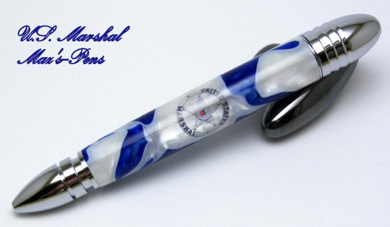

This one was requested by a friend at work, for his friend who is a U.S. Marshal. The blank is from PSI, the badge is a printed decal and has a CA finish. Kit is a chrome civil war.
Any Comments welcome, And Thanks for Looking. :)

Nice choice on the blank. Nice work with the decal and choosing the color. Couple questions. Being it was a 2-tone blank, any problems with the decal covering both colors and showing through or were you able to find an all white spot on the blank??? Also was this a white background decal or a clear??? Any problems applying CA over acrylic and is there any chipping problems later on??? Thanks and thanks for showing.

Hello Max, Couple questions. Being it was a 2-tone blank, any problems with the decal covering both colors and showing through or were you able to find an all white spot on the blank??? Also was this a white background decal or a clear??? Any problems applying CA over acrylic and is there any chipping problems later on??? Thanks and thanks for showing.
I am going to go backwards to answer your questions, I have done a bunch of these over the last year or so and have not had any reports of chipping or peeling. After applying the decal I let it dry for 2 days before applying the CA, to get rid of all of the water (I have rushed one or two and got some clouding in the past).
I have not had any problems applying the CA to Acrylic, I use thick CA and Apply with a plastic bag on slow speed, Mist with Accelerator, let dry and re-apply 4 or 5 coats, Wet sand to 600, MM, plastix polish and buff.
This is a clear Decal and works best on a white background, I could see that this blank had a large white area so I set it up to be in the center more or less. The clear decals lose their contrast on dark colors and appear to be absorbed by the darker colors, which can be used to give some good special effects. I hope this answers your questions satisfactorily.
