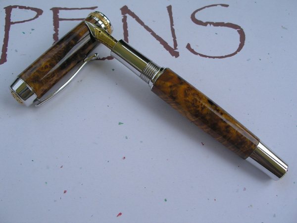

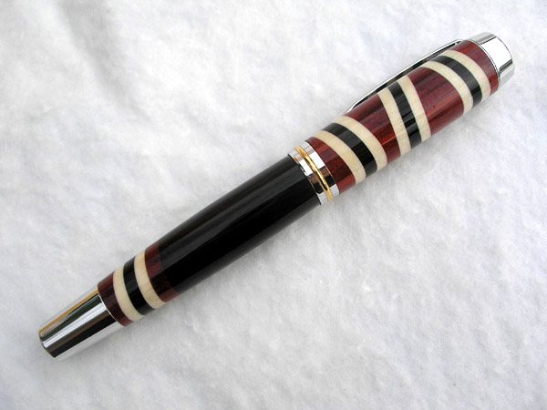

Haven't posted much lately, but I was really pleased with the way these turned out. The first is a custom order, a full size Gentleman from Blackwood, Bloodwood and Holly. The second a Statesman from Chittamwood Burl. I'm keeping this one!

You know darn well that the first pen would catch my eye! Nicely done. Clean joints and I don't see any bleeding of the colors at all.

Your customer should be very pleased. When he pulls that out in the boardroom, folks will take notice. It is definately a 'power pen'. And your burl fountain is beautiful. Personally, I would keep the beautiful wood one for myself too. [;)]

That segmented job is great. did you get much bleedover in colors while sanding from the black and red over the holly ?

Linc I use thin CA and saturate the holly when I glue the blank up and again several times as I turn. Finish with a skew to minimize sanding and then saturate again between sanding grits. Blow off with compressed air often and you'll end up with nice clean colors. [8D]
