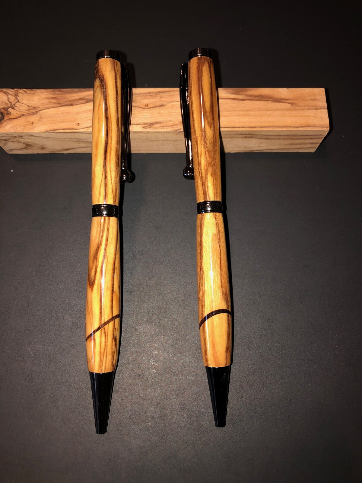

These are Olive Wood with Claro Walnut accents. Micro Mesh then polished off with Meguilar's Ultimate Compound. The combination really produces a brilliant shine. Hope you like them!

Very nice! You used Meguiar's Ultimate liquid wax on them? Have you used it before? How long does it last? I would think a wax would rub off after time.

Thank you for looking, and the kind comments! I really like turning olive wood. (I just noticed that I didn't mention that this is CA finished, then Micro Mesh polished.) OOPS!
Let me answer a couple of questions.
I am no chemist, but this isn't a wax, it is a polishing compound. As for application, a tiny bit applied with a soft, clean cotton cloth onto the blank while it is on the lathe, without the lathe turning. I rub the compound in very gently, mainly so the whole blank has a bit on it. Then, with a new, soft cotton cloth, I start rubbing with the lathe at low speed, and after less than a minute or so, I turn the speed up to maximum and polish it with a new clean spot on the cloth. I probably polish it for a minute or so, and it is done. I think it adds a LOT of luster to the blank.
As for the cost, I see that you can buy it for less than $10.00, and that bottle will last a lot longer than I will.
