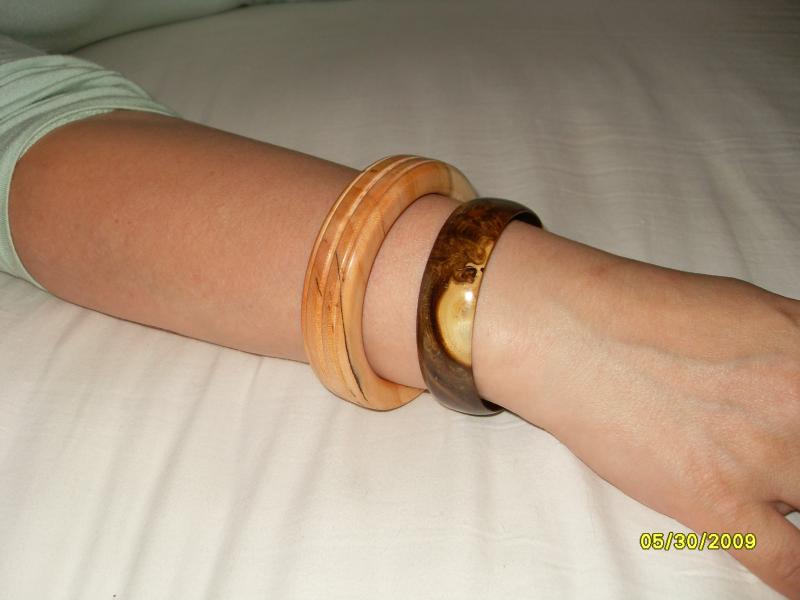

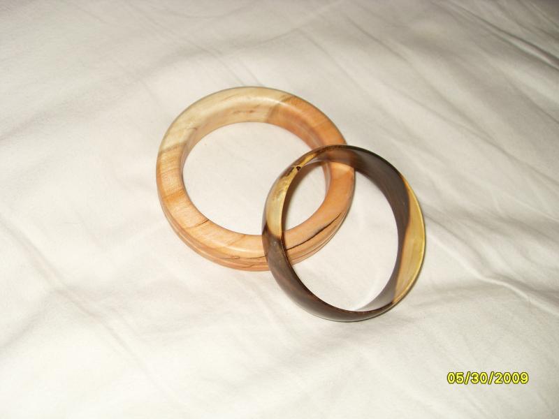

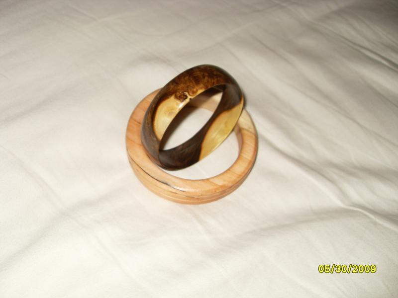

I took my girlfriend with me the other day to WoodCraft and she was looking thru the turning books and saw a few bracelets that she liked and showed them to me. While she was at work today I thought I would surprise her so I made these two for her.
One is Cherry and the other is Texas Ebony. As always, comments and critiques welcome.

But here is basically how I made mine.
1. Started with a 3.5" x 3.5" x 1.25" blank.
2. Mounted between centers and turned to a cylinder with a 5/8" bowl gouge and dressed the tailstock face.
3. Chucked it up with #3 Round jaws (outside grip) and dressed the other face.
4. Using a Jacob's chuck, I drilled increasingly larger holes with Forstner's bits until I reached an inside diameter of 2 3/8", I then used my shear scraper to make the inside diameter 2 11/16"
5. Chucked it up with #2 Round jaws (inside grip)
6. Used a bowl gouge, skew chisel, and shear scraper to shape the outside of the bracelet (be sure to roundover the inside lip to avoid a sharp edge there).
7. Reverse-mounted the bracelet to shape the other side.
8. Sanded to 400 grit rotating the bracelet on the chuck for each grit (only a very light grip is needed with the chuck to avoid marring the inside surface).
9. Gave them a coat of spray on Spar varnish, let them hang and air dry, and Beall buffed the bracelets to the final shine.
I'm not really sold on the spar finish but if it doesn't hold up I will try something else. The Texas Ebony one was not intended to be that thin but of course when I chose a bracelet out of her jewelry box to measure, I chose the wrong one. If you try to turn TE, let me tell you it is like turning stone, harder than a rock.
