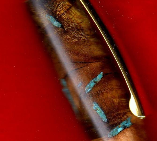

I take small chips of turquoise and put them in the cut off finger of a nitrile glove. Then I pound on it with a small sledge hammer until it is reduced to the consistency of sand with some almost powdered. (The powdered stone is used to fill tiny cracks and flaws.) I sometimes add one or two small chips of red or brown or white stone to add depth to the inlay. You can see some of the tiny colored stones in the picture.
I turn the blank until it is about a 32 of an inch proud of the bushings, then dribble in a little of the turquoise and a drop of thin CA. Repeat until the stone stands a bit proud of the surface of the blank.
Turn with a carbide tool (the stone dulls a skew REALLY fast). Then sand and finish with CA or CA/BLO. Put on enough coats that any slight irregularities in the inlay are smooth.
