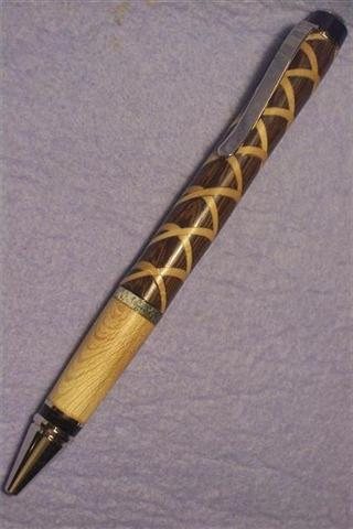

That's pretty much it.HIde the fitting and change the look of the pen.
Just because the Mfgr made it that way doesn't mean it has to stay that way.
I modified this Cigar in june of 05.I was asked to present it to David MArks.
I have also modified the hardware on Perfect fits, euro styles.
The trannys on my PArker bullet pens are sized to fit in the casisng on the wooden core.
You can also modify the Finials on Euro styles.
