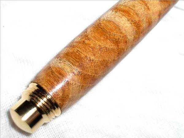

Must have been lucky with the cross-cut Honey Locust....you end up with grain looking like this:

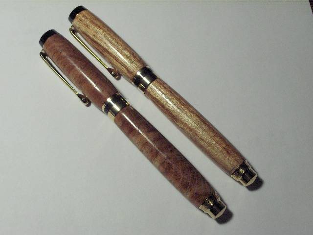

Same wood one is cross-cut one isn't:
