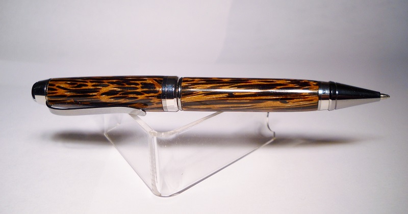

I tried unstabilized black palm twice and couldn't keep it together. I have heard that some people have had success turning unstabilized black palm. My hat is off to them, I can't even get it drilled without it turning to dust. I really like the look of black palm. This is from stabilized BP
