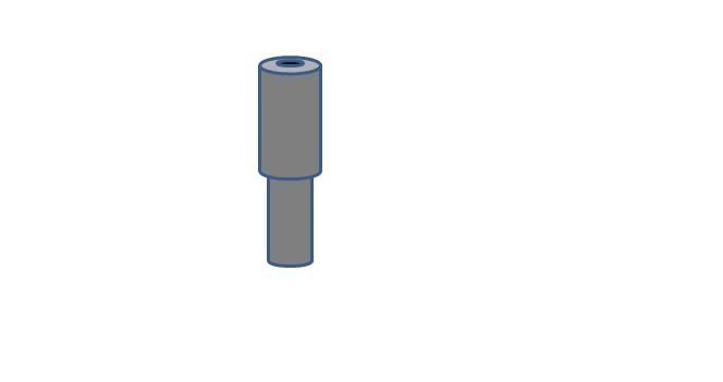

Mike, I've heard talk (actually read) about bushings for turning slimlines between centers, but I cannot picture what they would look like. Is there a picture available or can you describe?
Thanks
jkeithrussell
Oct 20, 2008
1,277
Thanks
It would look like a step bushing. The small end would fit snugly inside the standard 7mm tube. The larger end would match the standard slim bushing diameter with (hopefully) a flared end to meet the dead/live center. The size of the hole would not matter as long as the center could properly seat.

It looks like this. The small end goes into the 7mm tube and the large end is the outer diameter of the standard bushing. There is a 60 degree tapered hole in the end of the large end for the live or drive center. We used to buy them from JohnnyCNC but he had some flooding problems and is not able to make them at this time. Paul in OKC might be able to help you http://www.penturners.org/forum/showthread.php?t=37433
