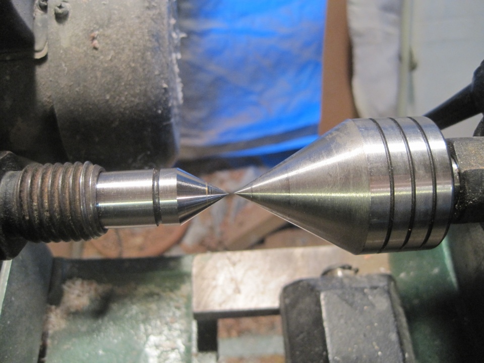

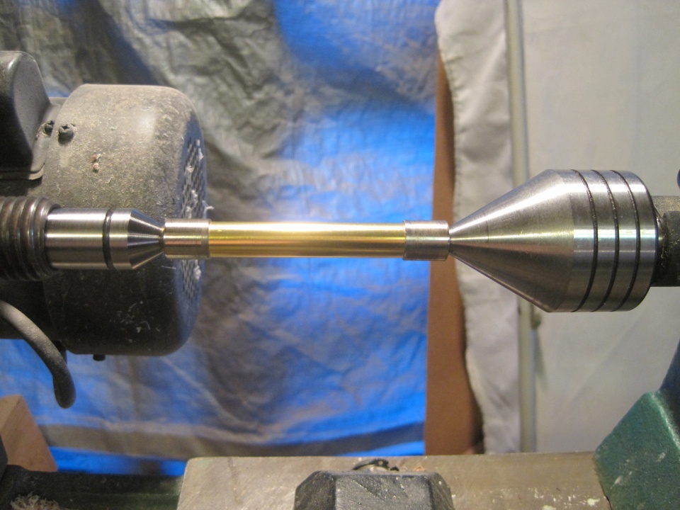

Alright, I received the dead center today and got my lathe setup. Will be doing a Honeycomb blank on it tomorrow.
Heres some pics
Thanks everybody for all the help!

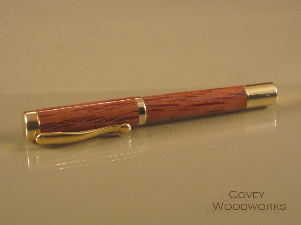

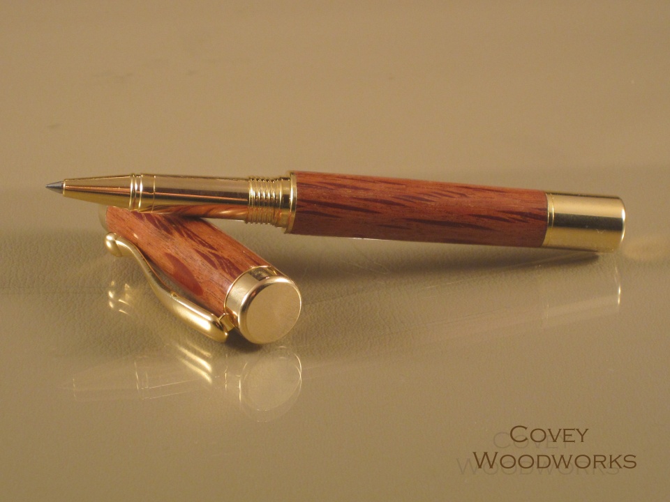

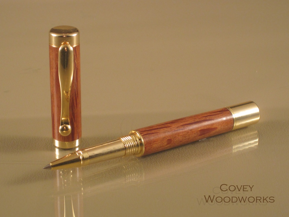

Well, I finally got some time to turn a pen between centers. I'm doing an Atrax Rollerball. So far I've gotten one half done and working on the second. I'll post some pics when it's finished.
So far I'm liking it, the pen is a lot more even than the one's I was doing on the mandrel!
I'm doing it completely without bushings, which is working pretty well for me.
